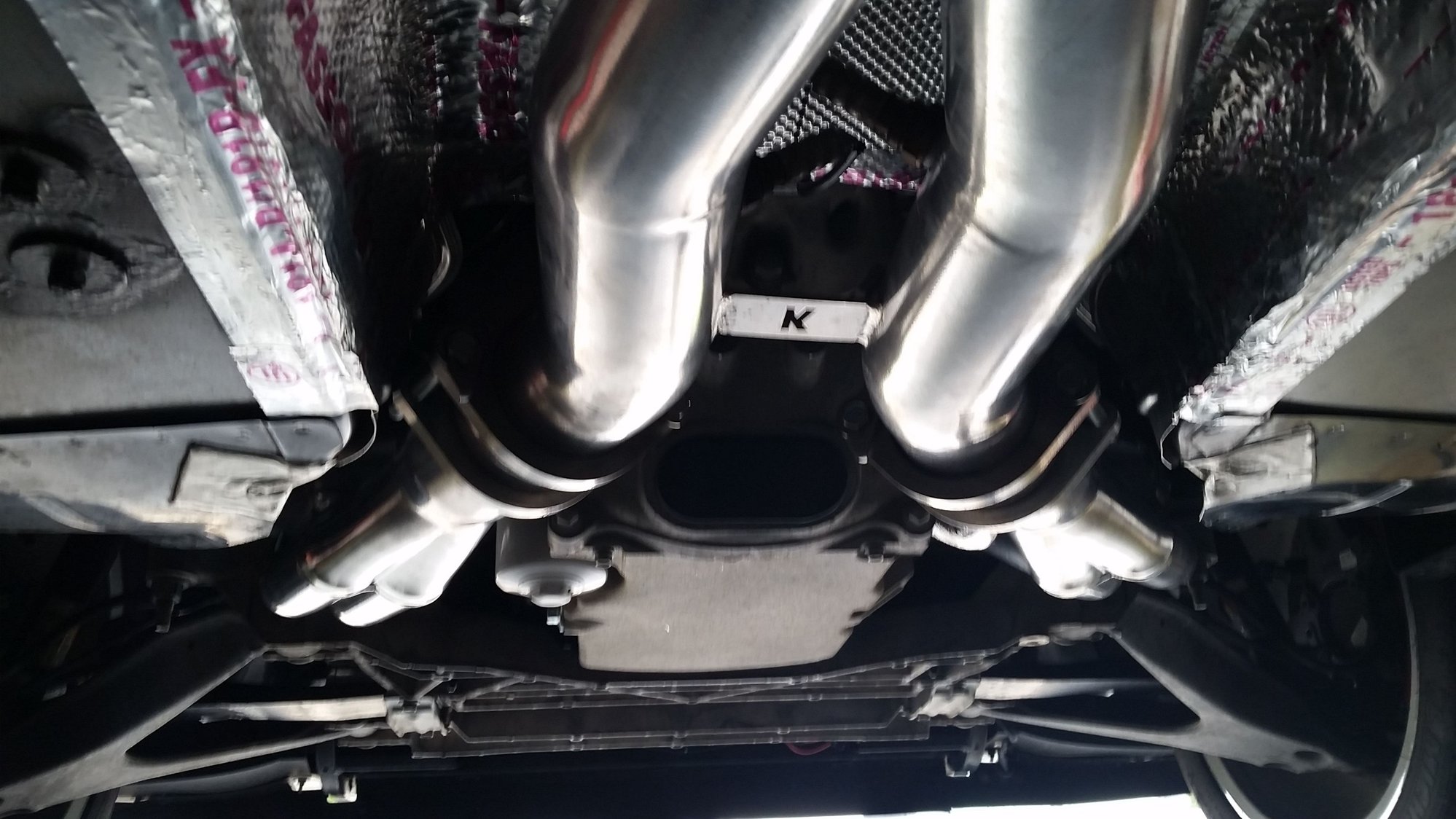

Old May 8, 2018 | 05:34 PM
C6Z06Silverbullet's Avatar
C6Z06Silverbullet
Joined: Apr 2017
Posts: 2,296
Likes: 386
From: Jersey
