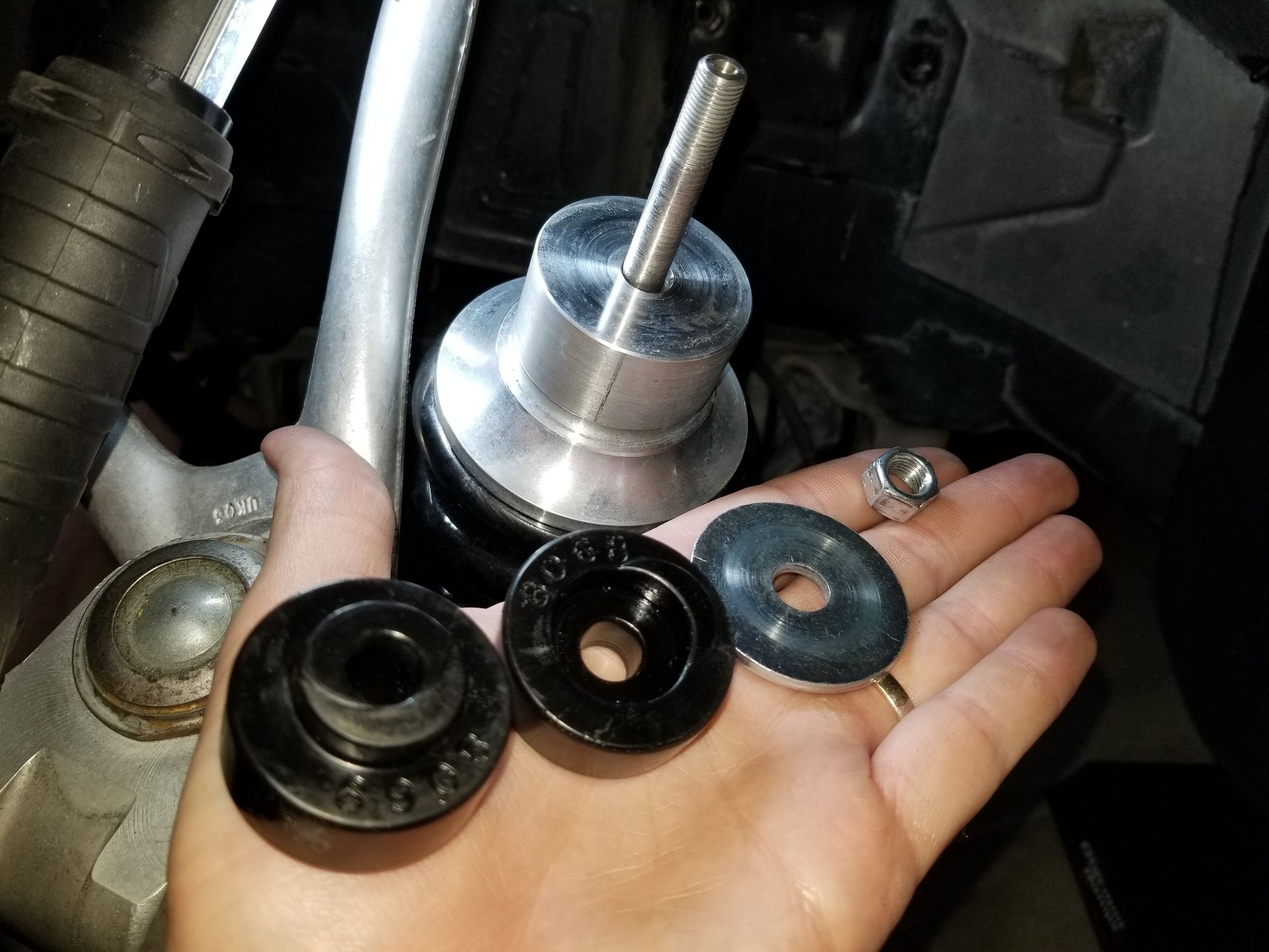

Guys I have a 2 part question relating to the Aldan coilovers that I installed back in May. I recently started noticing a knocking noise coming from the front end when going over bumps. Today I thought I'd take a look and make sure that everything was securely fastened.
Part I

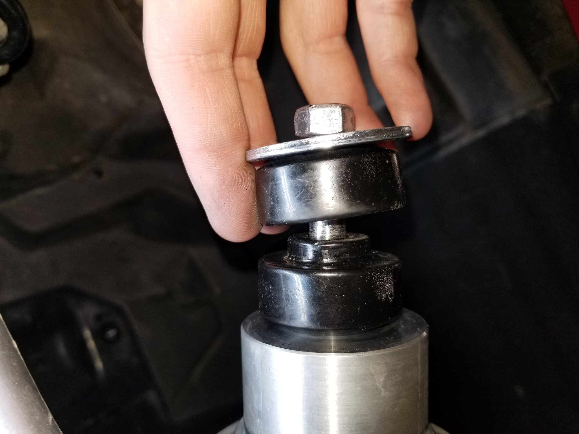

Upon inspection, I noticed that I had the bushings configured differently on the passenger side coilover compared with driver's side. Now I'm having difficulty confirming the correct order of the bushings. My kit came with a male bushing (#8069), female bushing (#8068), a flat metal washer, and a nut. Can anyone confirm the correct order for these bushings? I feel like the male bushing (#8069) goes closest to the coilover with the male end facing up, then the female bushing mounted downward to create a flush fitment with male bushing, then the washer, and then the nut as shown in my second photo. Is this correct?

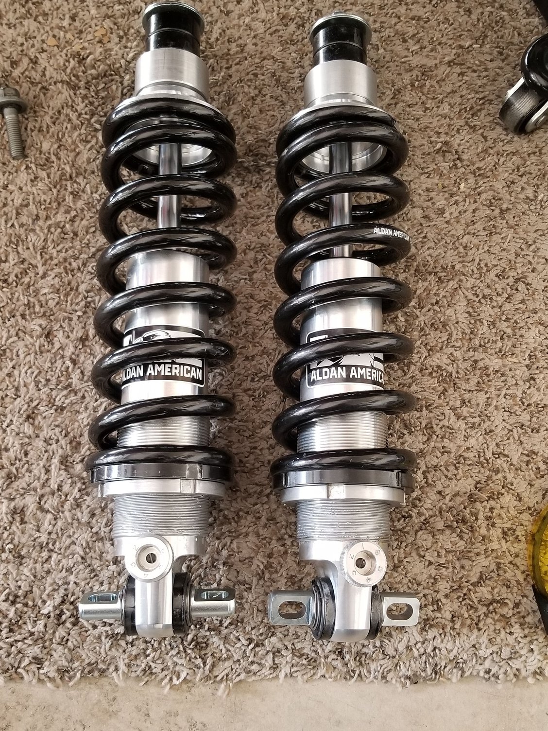

My kit right out of the box.
