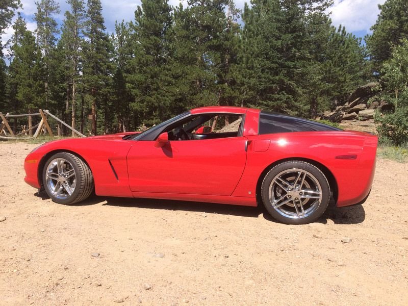

Told a friend of mine that, " ... this car will never be anywhere near a dirt road."
Screw that ... I drive it in the rain, it is kept outside. I can't own a pansy car.
