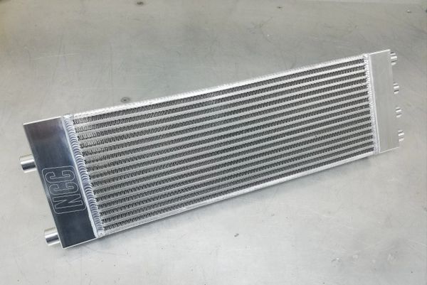

Anyone buy one of the Zo6 oil coolers? https://nccfab.com/products/c6-facto...ent-oil-cooler

Looks to be an actual Radiator type cooler with multi passage channels through it, over the OEM cooler that is just pipes with cooling fins on the pipes instead.
So what is there not to like about it, since your going to get a lot more heat transfer with it for oil cooling.

The pictures
look good, but I was wondering if anyone had experience with the supplier. Thanks!

Never heard of them...but it looks nice. The OE unit is far too efficient for street use to begin with, so this would most certainly be for the track enthusiast if it proves to be even more efficient. I'd probably still go with a Setrab if I needed an upgrade.

Part arrived, looks just like the picture and installed just like the OE one. Not sure of any improvement in cooling because it has been raining and cooler since I got it. I have to be honest, even though no one will see it, I bought it because it matched my aluminum radiator and looks cool.

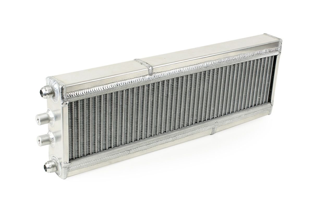

Here's our cooler. We have the end tanks running across the top and bottom for a triple-pass flow design, while minimizing pressure drop. Our cooler is also less expensive. They will be in stock within the next couple of weeks. You will also be able to purchase it separately from the complete kit and we will also have a generic version of this cooler without the C6 mounting bungs available.
http://www.improvedracing.com/oil-co...600-p-768.html
