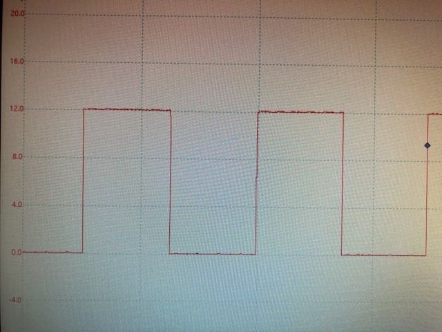

Still having issues my friend ??...ever find the ground for the coils ??...absolutely a bad CMP sensor can cause the engine to shut down randomly...does it happen while you are driving or a idle ??...one of it's functions is to control engine timing...I believe you said you have a scope...did you scope the cam signal ??...it produces a 0-12 volt square wave and you'll see it on the scope..(my LS1 CMP waveform pictured) ...Just make sure it you see 12 volts and then gets pulled down to ground....you don't want to see say 2-10 volts !!...but it does sound like a cam sensor !!

Is yours on the back on the intake manifold like the C5 ??...so you have a new cam sensor fitted today...is it an OEM or aftermarket ??...any "sensor" on the Corvettes I'd stay away from aftermarket ones...i.e Dorman etc...my Autel shows a CMP signal low to high and high to low...it just counts up I think to 65,000 or something like that...I just had a P1518 pop up on mine last week and think it's a bad ignition switch...99.9% sure...I have a switch on order. car would not crank and had a low voltage on the DIC looking at me...I know my battery is fine...cycled the ignition switch a few times quickly and it started...my quickest diagnosis...LOL !!!
