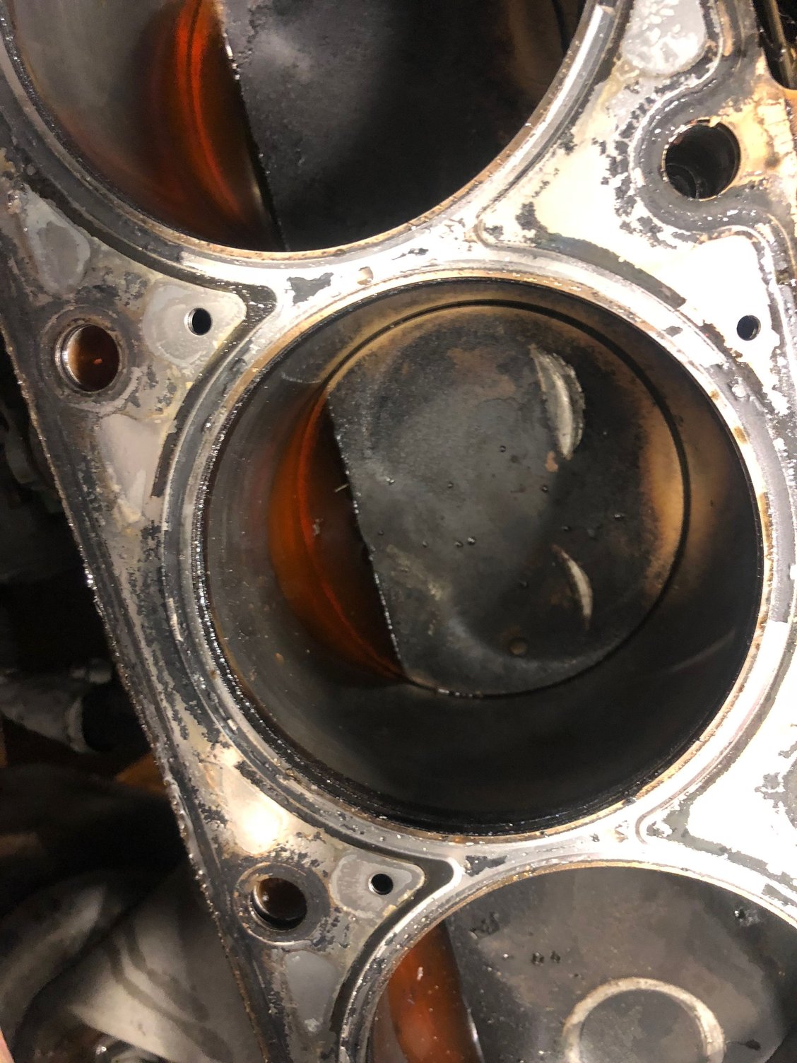

Update: pulled the heads and I've got impacted pistons. I'm pretty mechanically inclined but I don't know a lot about engine building. With the help of a more knowledgeable friend, we're going to replace the heads, cams, timing chain, timing gear, valves, and pushrods. What exactly needs done to replace the pistons? Do I need to pull the entire block and send it to a machine shop? And if so, what would the machine shop be doing and how much should I expect it to cost?
Old Dec 4, 2018 | 04:07 PM
BigVette427's Avatar
BigVette427
Joined: Aug 2013
Posts: 1,502
Likes: 515
From: Hill Country Texas
I'd suggest an LS3 crate motor (480hp or 520hp variant,) or at least a used junkyard LS3 or maybe a L92 truck motor, and then you can pull your current motor, and either salvage what you can, or rebuild it and sell it to recoup the investment into your existing LS2.
