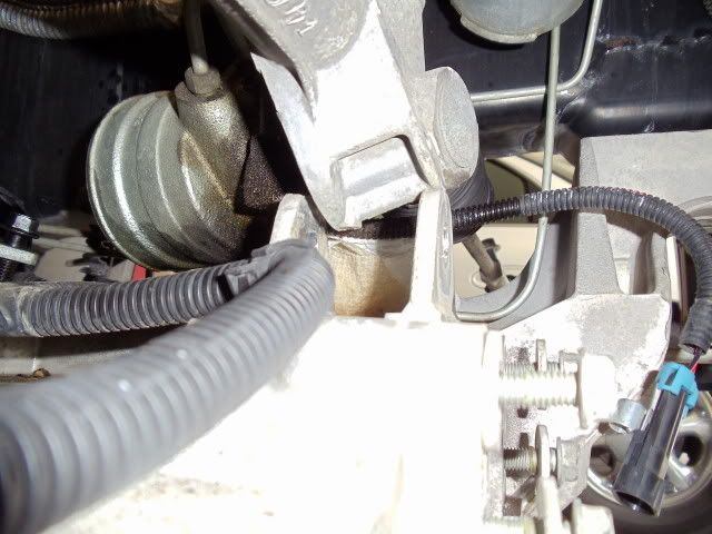

Sure. You'll have to sort of figure this out a little as you go, but the steering rack connector isn't easy to get to without the car on jack stands. Here's a photo i found from a different thread on here that shows the connector. Its the one on the right with the blue piece on it.
You don't have to disconnect anything to reach like what you see below, but i drew an arrow to where this is located on the vehicle. Just behind those two pipes where the arrow is pointing. I had to spray electrical cleaner in the connector and it solved my issue.

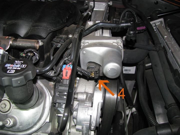

The throttle body connection is super easy to access. Its on the passenger side of the throttle body, the arrow is pointing to it in this photo
I'd inspect this, make sure its a solid, good connection, that there is no damage to any of the wires or connector or that there isn't dirt somehow inside this connector either. Again, I've heard that several people have had to resort to replacing the throttle body to fix this but its worth a shot. I think if you ever throw a belt, and that wire isn't secured properly that it can damaged the wire.
