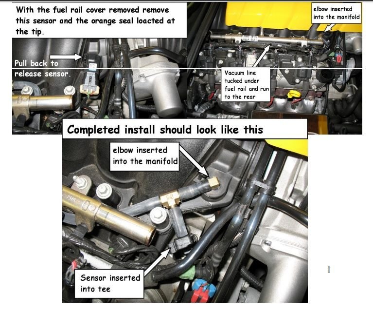

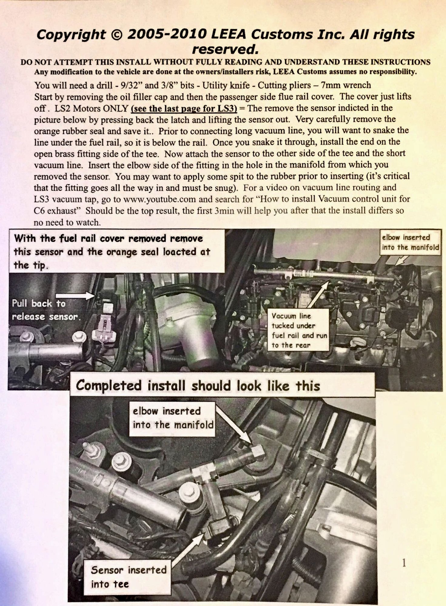

I believe this is what you are looking for...

With the EZ tap you do not go behind the intake manifold it's up front and on the side of the intake manifold.

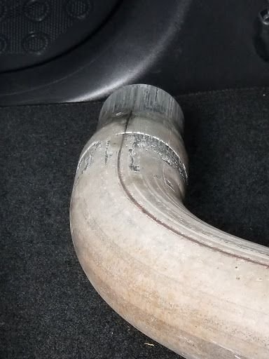

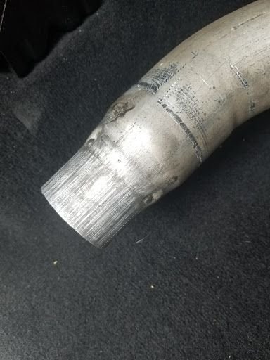

Got my Z06 dual mode mufflers back from the exhaust shop who reduced the pipe from 3'' down to 2.5" so it will hook up to the base C6 exhaust, wanted to post the pictures here in case anyone was interested:

Here is where the EZ Tap goes.... you remove the MAP sensor, and the is basically a "T" in the line to give you the vacuum access
Old Jun 7, 2019 | 12:48 AM
gpruitt54's Avatar
gpruitt54
Joined: Jun 2014
Posts: 1,431
Likes: 233
From: Chicago Illinois
OK, I see now. The paragraph of instructions that proceeds these illustrations says nothing about the EZ Tap. Thank you for your simple and direct clarification.
