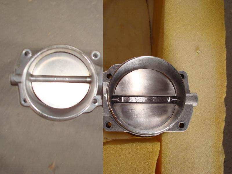

Here's the before and after of a ported LS2 TB:
IIRC, it's a gain of ~5hp on a moderate bolton setup.

Gain will be ~ 5 rwhp, more important will be the throttle response.
102 TB = Waste on ls2 , below 500+ rwhp imo.
I would and did get the V-Max Velocity Ring to eliminate the step/gap
between the 90 MM TB & the 102 MM entrance to the plenum,
that will definitely help the low speed/idle transition with the larger cam

Thank you for your insight in reference to the specifics. Indeed, my reference point is from one of the smaller vendors that ran some tests in this regard.
I beg to differ on the 500 rwhp benchmark - it would be much lower, based on the vacuum properties of air as it's inducted in this case. But I digress...
I'm interested to see you have the transition from 90 --> 102, that is the best utilization of implementation.
