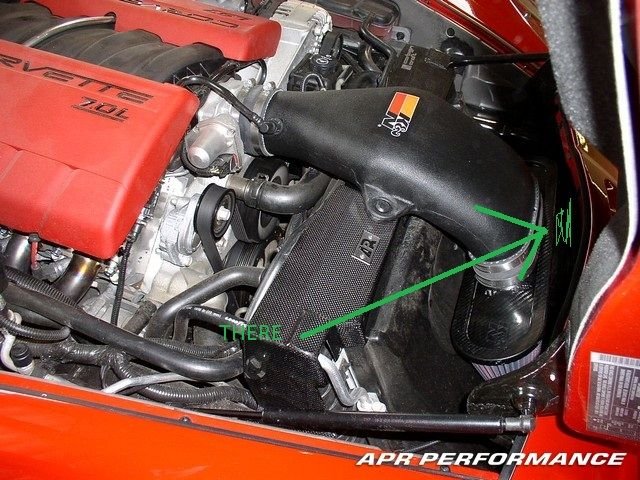

I have a ECS S/C setup where the air intake is relocated to the front and right side of the radiator. Just were does this duct send air flow?

The indicated area is where the inlet lets the air in. Ahead of the stock location for the air filter and ahead of the radiator shroud.
