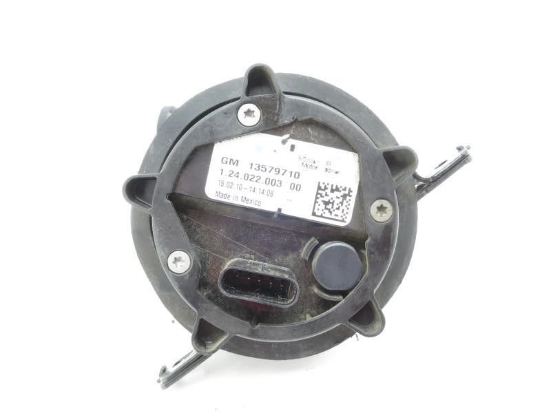

I am working on a LS9 crate engine and using a Chevy VOLT 5 pin coolant pump. I did some searching but couldnt find how to wire it? Also anyone know where to get the pin connector the pump?

Originally Posted by jft69z
See if this helps. I picked a 2016 Volt.
Thanks. If i understand it correctly, I need PINS 1,4,5? and also a 50A relay?
