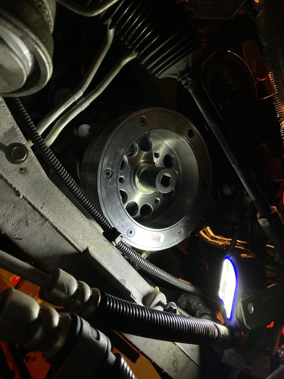

I just installed this balancer a few weeks ago, seemed like it is built well. I also recommend putting a little red rtv in the key-way on the balancer to ensure there are no oil leaks. Not too bad overall to install. Take your time and try not to swear too much while reinstalling the power steering pump! LOL Oh, and pick up an ARP balancer bolt as its reusable and great quality!

Thanks! Just to clarify - i always over think this stuff. Thread lube on the beginning of the bolt and the last few threads with red loctite (and also in the keyway)? I appreciate the picture.
