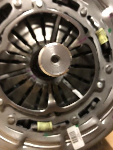

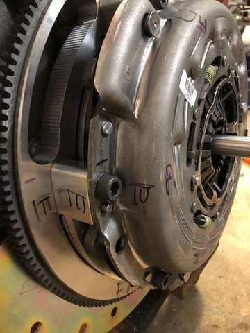

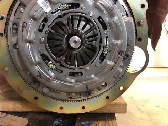

So, let me go through based on your photos, what has happened. I'm going to be very blunt
First, From looking at your photo, I see your transmission is sitting on the floor. One does not need to remove the trans-axle to R&R a clutch kit ! A waist of time and money. Trans-axle with torque tube can be supported and moved rewards.

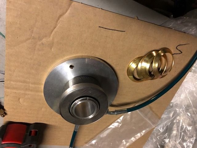

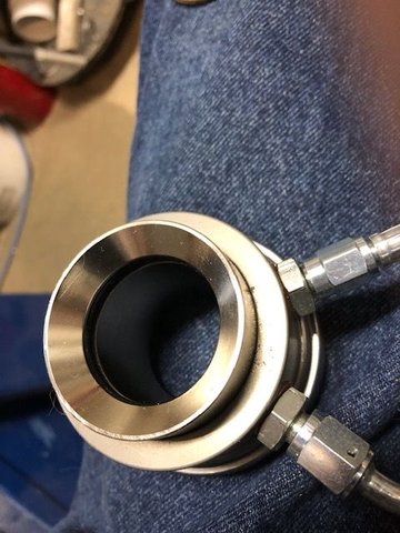

Next, the Hydraulic Release Bearing is clearly seen on the bottom of the bell housing. As posted, this is Impossible if it was properly placed on the transmission main shaft !! Therefore the release bearing was improperly installed by someone who obviously should have know better ! This person was probably pushing the trans-axle forward and it most probably jerked forward and Knocked the Release Bearing of the main shaft and it fell and was caught on the Pressure Plate. The practice is too Always check Visually that the release bearing is properly on the transmission main shaft before the Unit, Torque Tube or Transmission is fully seated !!
If you wondering how the release bearing disengaged the clutch a few times, that's not complicated. The release bearing fell such that it landed on the pressure plate fingers . After a few clutch cycles, it snapped. I've personally seen this happen, it's almost always catastrophic. The person who test drove this car is lucky that pieces didn't pass through the aluminum alloy bell housing !!
IMHO, This SHOP needs to return your money and pay for the damages and any rental car expenses. \\

Here are few photos of a Monster pressure plate (3 disc) and a billet release bearing. And yes, they do look very similar to a C5 or C6. This release bearing is shimmed by adding one brass conical spacer. I needed to add a shim because NHRA rules call for a Steel block saver Plate between the engine block and the T-56 transmission.
I have spoken with GM Engineers and Tremic Engineers. They insisted that It is "prudent" to check the release bearing clearance and bell housing alignment on every installation. But both had said they never or heard of a need for shims for a release bearing or offset bell housing dowels, With a GM bell housing and flywheel respectively. This is primary because the oem bell housing are cast and then precision machined.

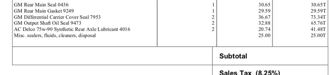

Car is done! Pick it up tomorrow morning. With everything it came to $1870. Shop picked up all costs, including shipping, associated with install error.
Also replaced rear main seal/gasket, both axle output seals, and both diff cover seals....fluids, misc, tax.
not happy about being without my car for almost 3 weeks but excited to get it back! Hopefully smooth sailing from here on out.
clutch install was 15.5hrs at 100, tax was $56. Rest is in pic. Was quoted “around 1500 for clutch install and rear main seal”
