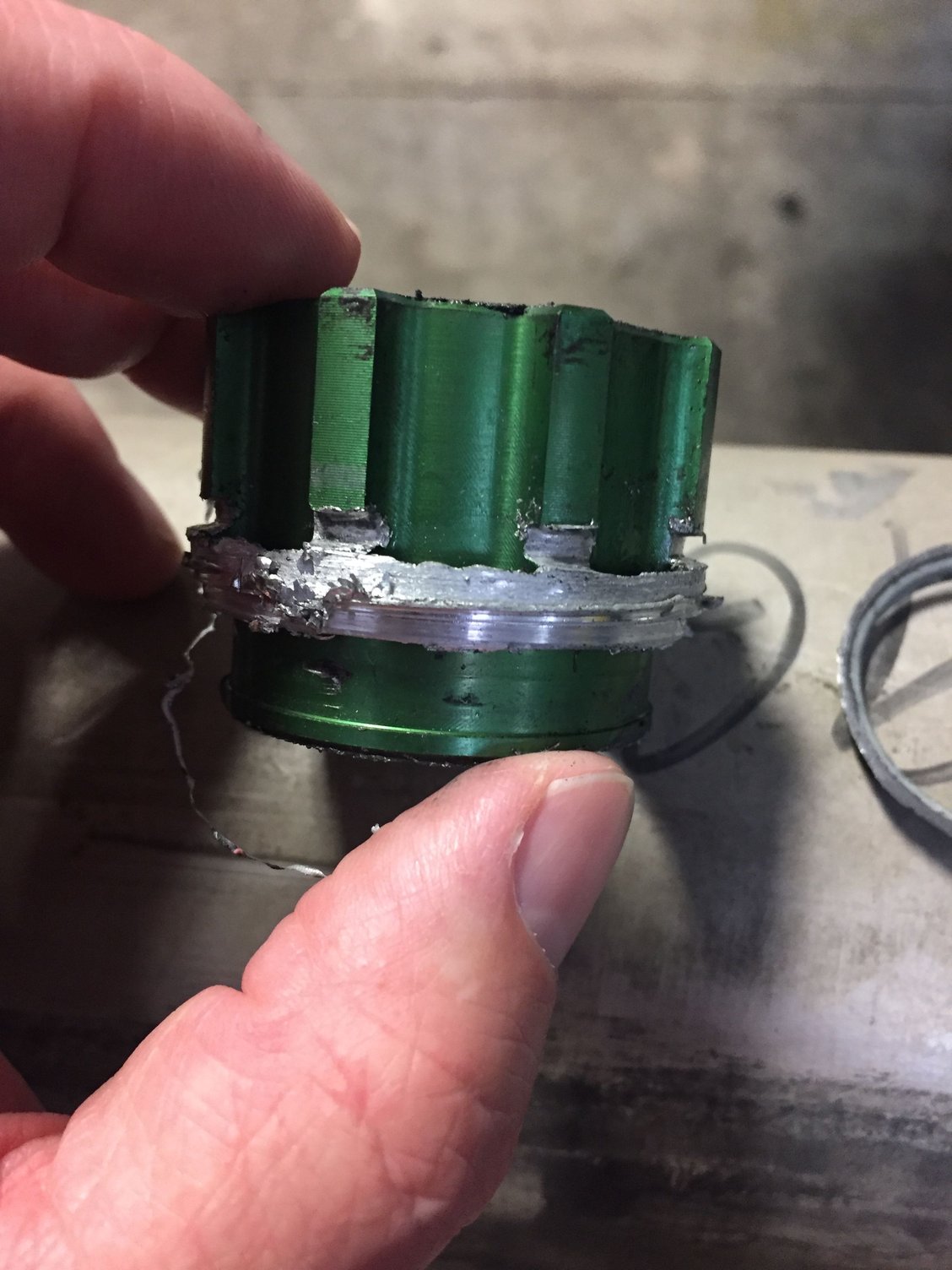

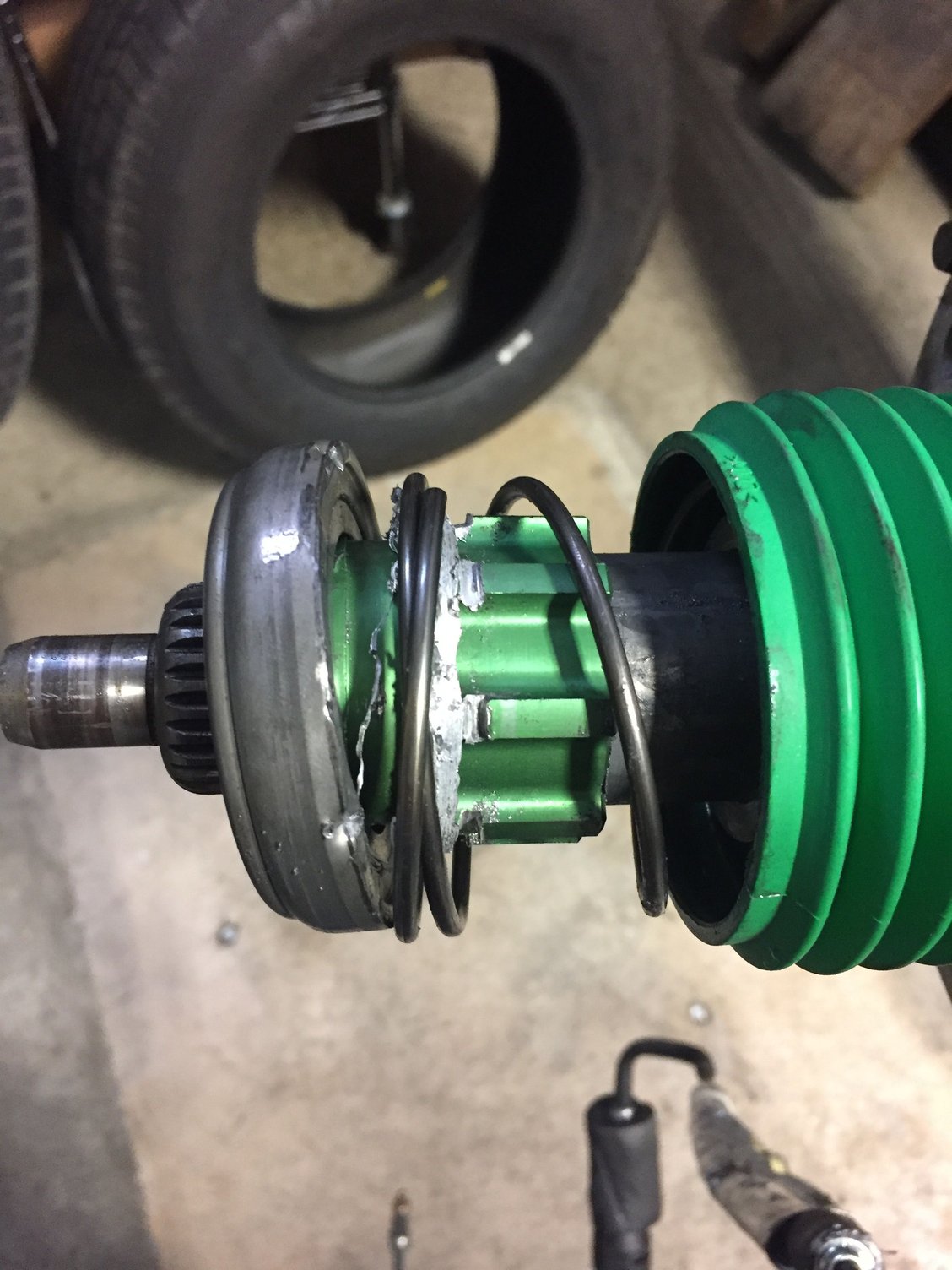

06 w/ 150k+ miles. Got a monster lt1-s with slave, speed bleeder, and billet bearing support. Brought to GM specialist recommended by my tuner, several vettes outside when I drop it off.
install takes a few days longer than expected, my daily, but it is what it is. Car is back together and immediately has issues on test drive.
TOB sitting in bottom of bellhousing
Slave carnage
$85 billet support bearing chewed to chit
By clutch fingers
Need new slave, new billet support, and to ship clutch back to Monster for inspection/possible repair.

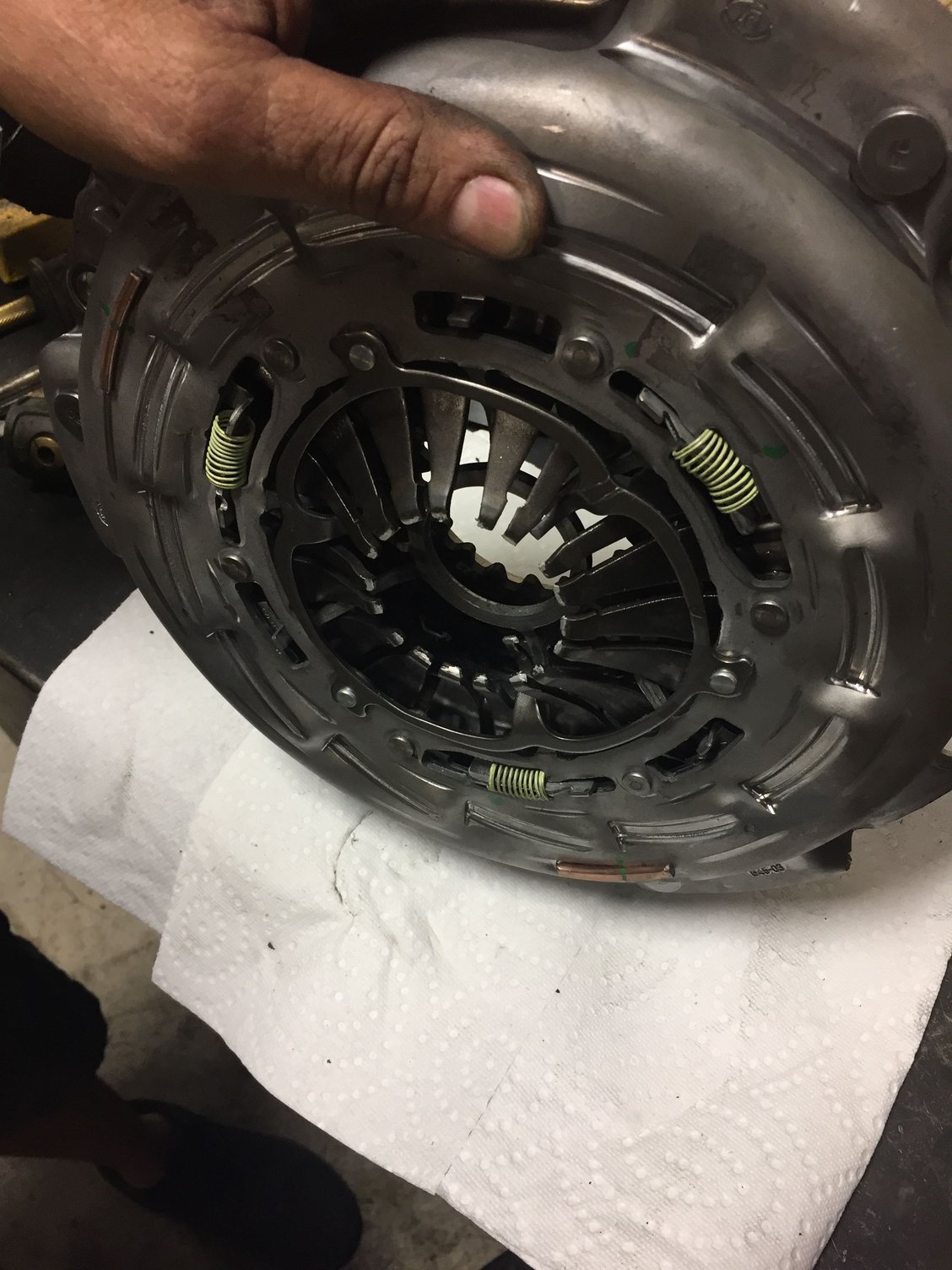

Clutch arrived today and pressure plate is ruined. They need flywheel and hardware sent back to so they can repair/replace. Estimated $5-600 damage to clutch on top of destroyed slave and billet bearing support.

The throw out bearing had to fall off during install. The input shaft goes thru the TOB and into the flywheel. If measurements were off (and Monster says in instructions to measure everything) then it would have rattled, or not engaged/disengaged. But there is no way for TOB to come off input shaft if it was installed unless input shaft breaks (it didnt). So when they depressed clutch, instead of TOB pushing into clutch, the slave itself was pushed into clutch and shredded.

Originally Posted by Krusty84
I guess I am confused. So was the TOB laying in the bell housing when they pulled it back apart or was it still on the input shaft like the photo?
No, the TOB was in the bottom of the bellhousing when he threw it in the lift after the test drive. He just put it on input shaft after he tore everything apart to keep things in proximity...

Got clutch back from Monster today. It arrived there yesterday afternoon and they had it fixed and back on my doorstep less than 24 hours later (I am in San Antonio and they are up by Ft Worth 4.5-5hr drive). $624 to fix (includes $21 to replace dowels that were damaged in return shipping and $50 return shipping). Cost me $119 to ship it back to Monster. Shop order slave (est $200) and billet bearing support ($85)... so this was approx $1050 error an extra week or more (i dropped the car off 2 weeks ago today and it took several days to start working on it due to issues with the car ahead of mine). Tomorrow will be 1 weeks since doomed test drive.
