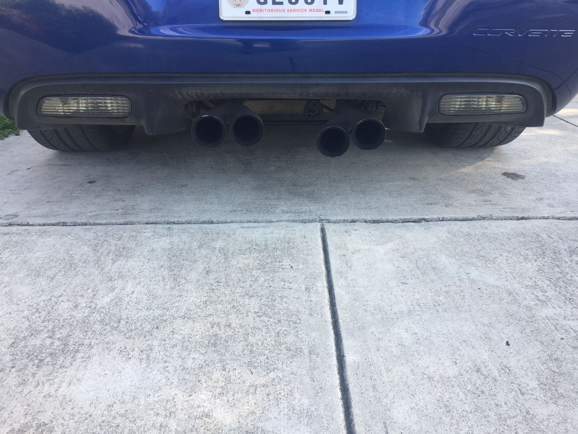

Are my expectations too high (that my exhaust tips are kinda close to lined up when I get it back)? New plugs arrived today and tc button should be in tomorrow, so will align the exhaust this weekend as well.
Derpy exhaust
Shop - "That's how it was when it came in"
haha

what? this is how you got it back?
yep, and it didnt go in like that

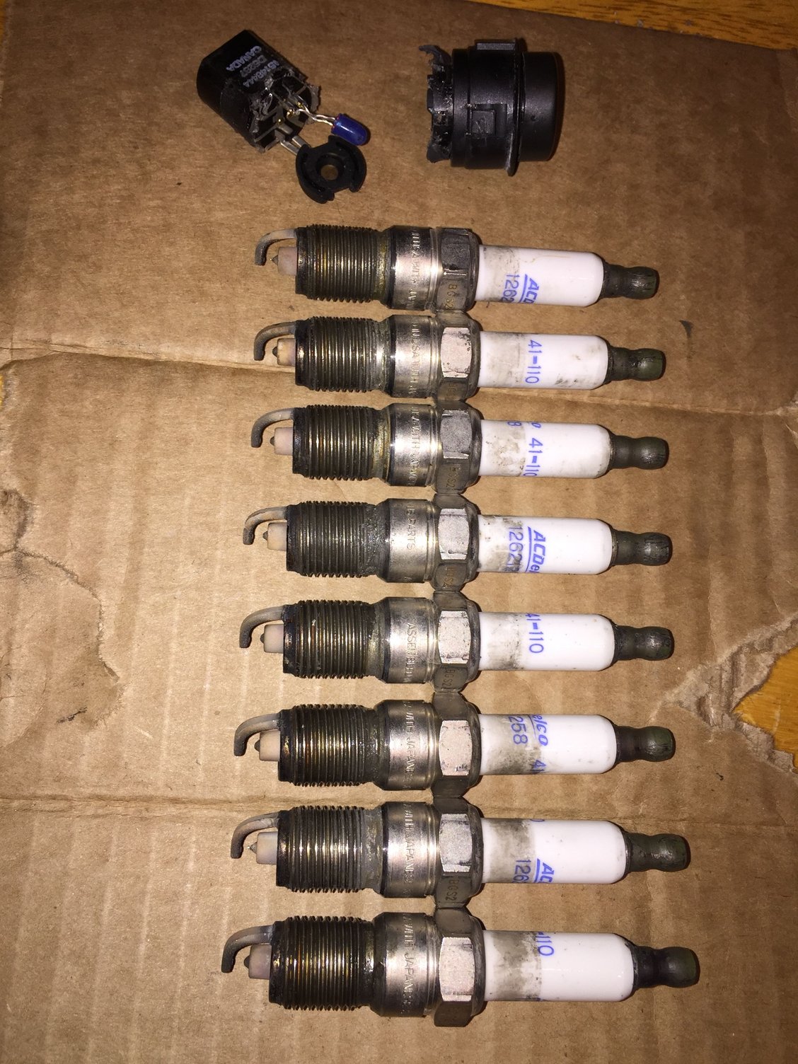

Fixed TC button then jacked it up to align exhaust and when I crawled under there I saw he just left an exhaust hanger undone. I still adjusted the over axle piece a little to get a little more clearance from the body. Tips still arent perfect but close enough at this point.
then I slapped in a fresh set of AC Delco 41-104 plugs (z06/zr1...1 step colder than stock)
all is well, now just need to break in this clutch and not break anything else!
here are old plugs and busted tc button, it broke in half when I unplugged it. Notice how high the button sits above the bevel? That is what clued me into it being not right
