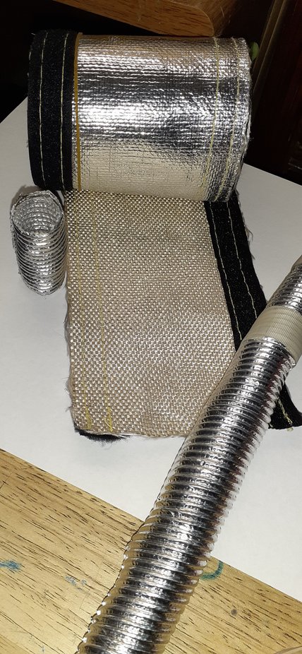

I already have this stuff in the garage so I'll try the convoluted tubing with the velcro stuff over it or just one or the other on the trans fluid lines.
See what happens.

I lost my A6 to overheating last year and had it rebuilt. At that time I added a Dewitt’s and a B&M trans cooler. The trans lines are about 3/16” from my long tubes and to prevent migration of heat from the uncoated headers I wrapped the headers with quality header wrap. The trans temp is much better now but not sure how much of it is from the wrap but it certainly has a positive effect on keeping fluid temps lower.
Charlie- dont know what brand/ temp rating of that insulation you posted there but a lot of those insulation’s directions warn to not put in direct contact with very high temps. What’s good to wrap the starter likely won’t meet the temp rating of header wrap or insulation that that withstand direct header heat. It might catch fire. Just a heads up.

I 'tweaked' mine a little bit and wrapped them in the same stuff you have picutured. So far so good.
