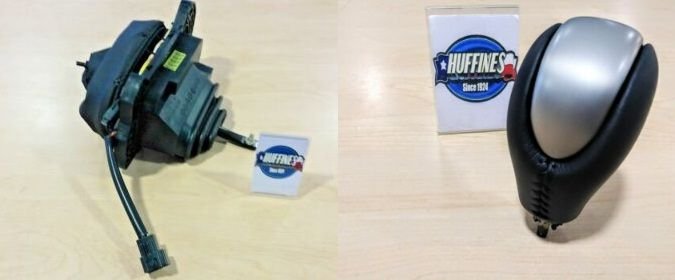

These are the two parts I have coming. When you mention assembly is there anything else I need?
To me this looks like a removal, and then attaching to the cable connection and one electronic plug. Seems fairly straightforward. Hopefully....

It’s extremely easy and very straight forward. Good luck and please let us know how it turns out.
