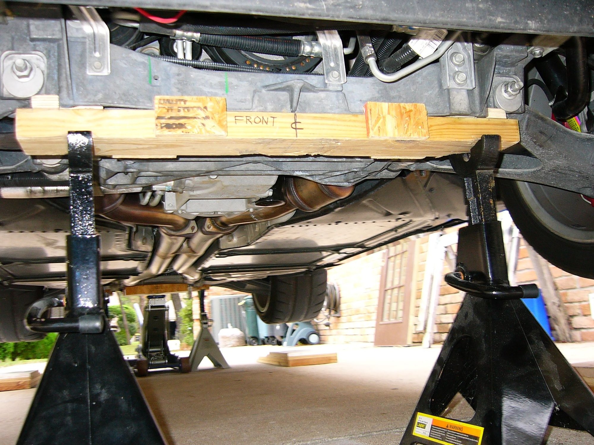

Here's one way to lift & support the front end. The jack goes under the 2x4 at center to lift the front end, then jack stands are placed at each end to support. Same process is used at the rear.
