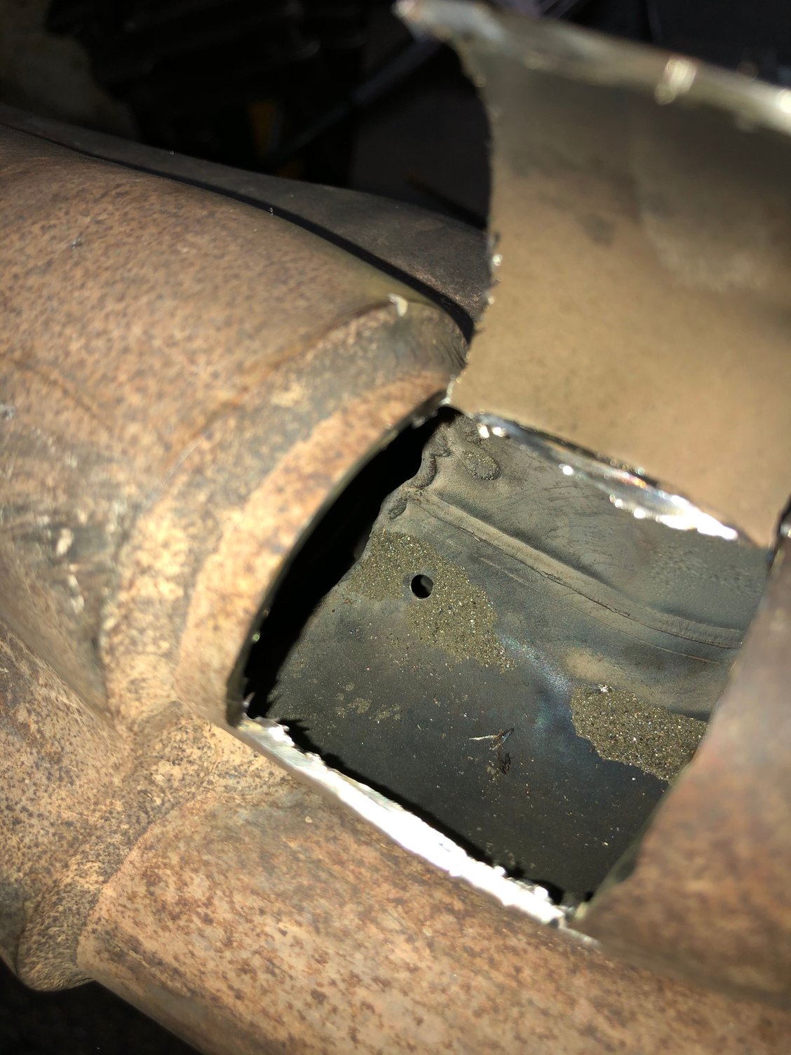

Anyone had this problem.
I have a lg headers 1 7/8 only 16 k km in 4 years on them I’ve been hearing some leaks in the driver side headers and I had 2 new codes 171& 174, yesterday I took out the headers removed the heat wrap and noticed a small hole inside one of the 4 pipes, I cut the pipe & saw this, can I just weld the hole and the pice back, will this last ?? Thank u guys .

Weld it up. Remember it’s stainless. FWIW the header wrap is probably the cause of your problem.

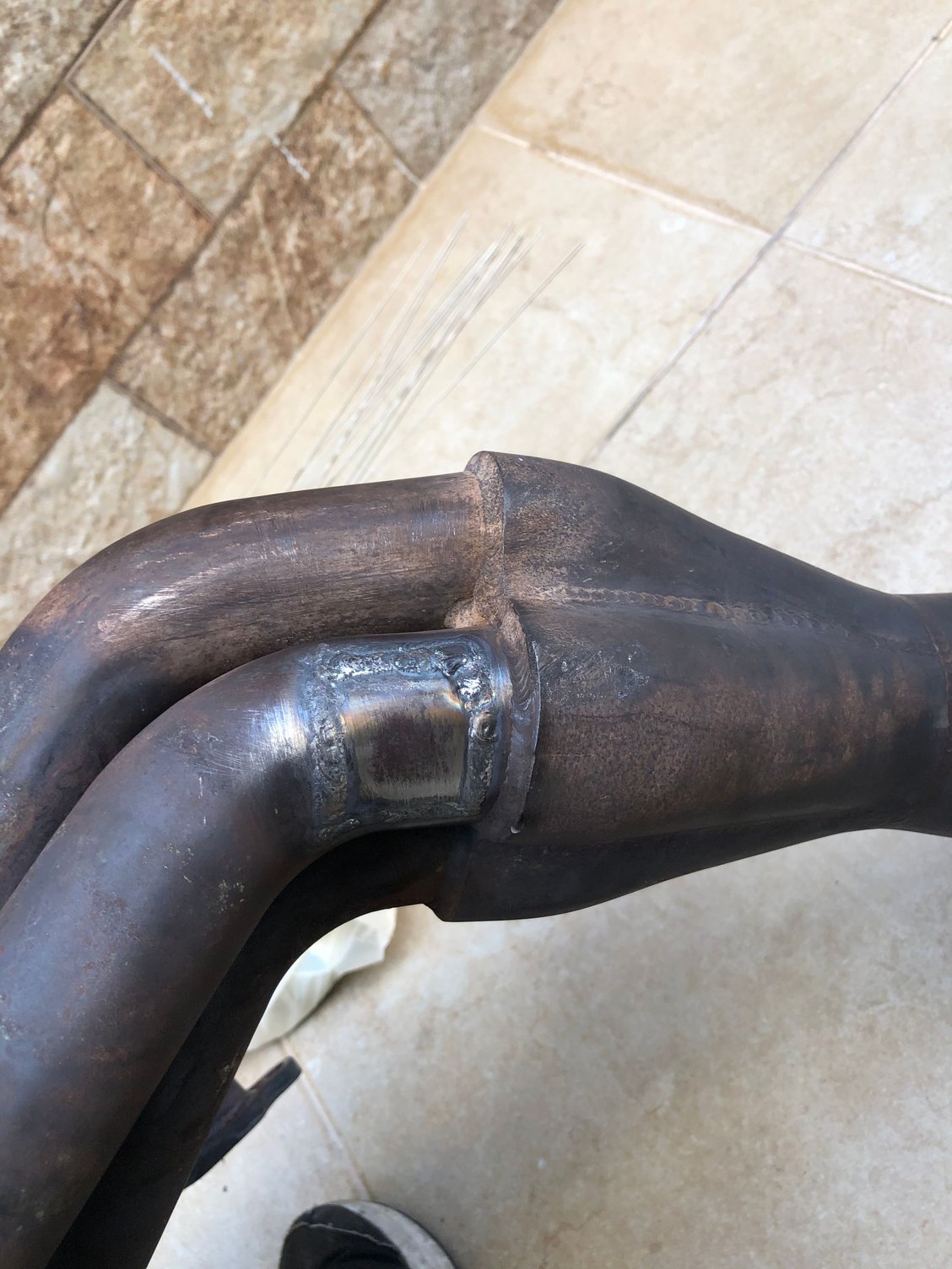

Thanks for help, I just put it back in place after having it welded,but the guy Who weld it says that this is a factory defect I’m not expert. Hope it lasts.
