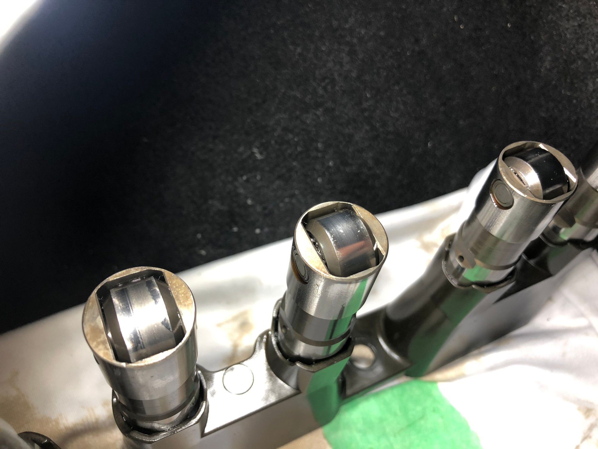

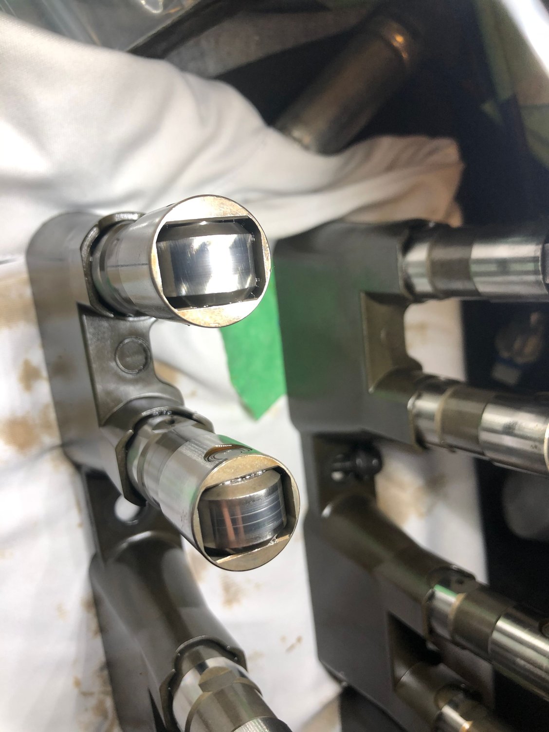

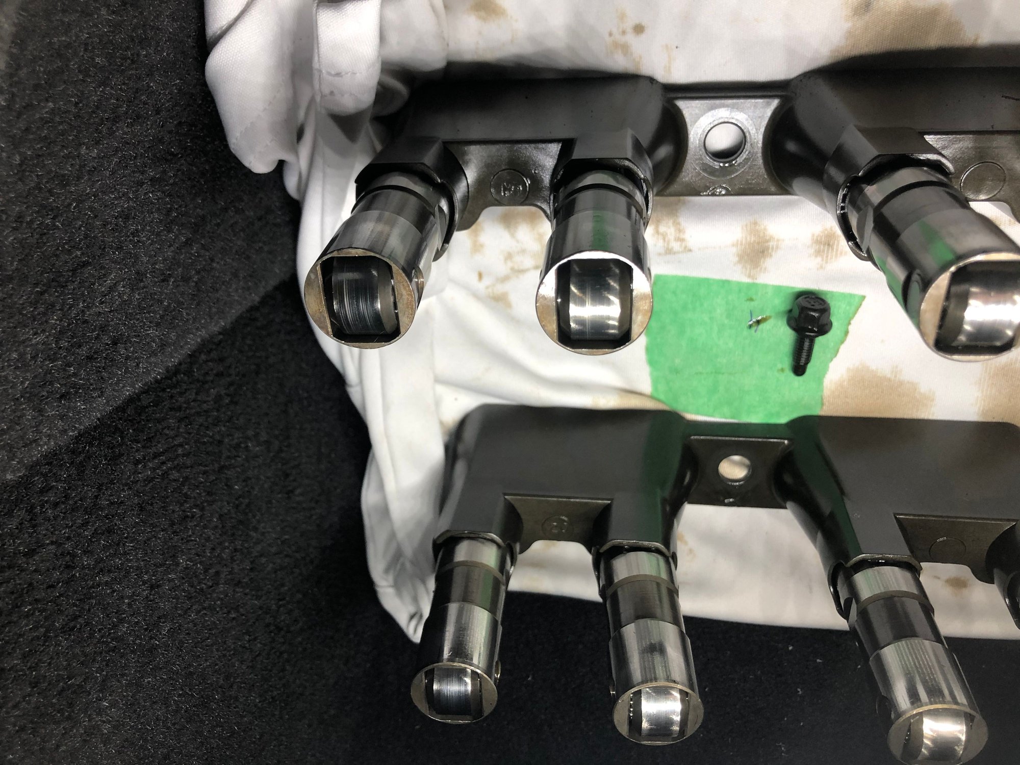

One of my lifters is shot for sure but can I get away reusing these lifters and replacing the one shot one? Ive attached pictures of the worst ones. They are out of stock everywhere and I really dont want to spend $800 on new lifters from the dealer.

Looking at the condition of your damaged lifter rollers, I can only imagine what the cam lobes look like too ...
I would also replace your plastic lifter trays too .... they are not expensive

Yeah, it would be nutso to just replace one lifter. At a bare minimum, I'd replace cam, all lifters, and trays. You have to pull the heads to replace a lifter. Fix it right or you'll be right back in there.

Try Juicedmotorsports a vendor here on the forum.GM Performance lifters p/n 88958689 $279. if he has any left.Best lifter GM has.Avoid the Chinese knock offs on ebay as some only last 2 days before they fall apart

https://www.high-performance-engines...k-12499225.htm
Disclaimer: no affiliation, I don't know these people, etc.
