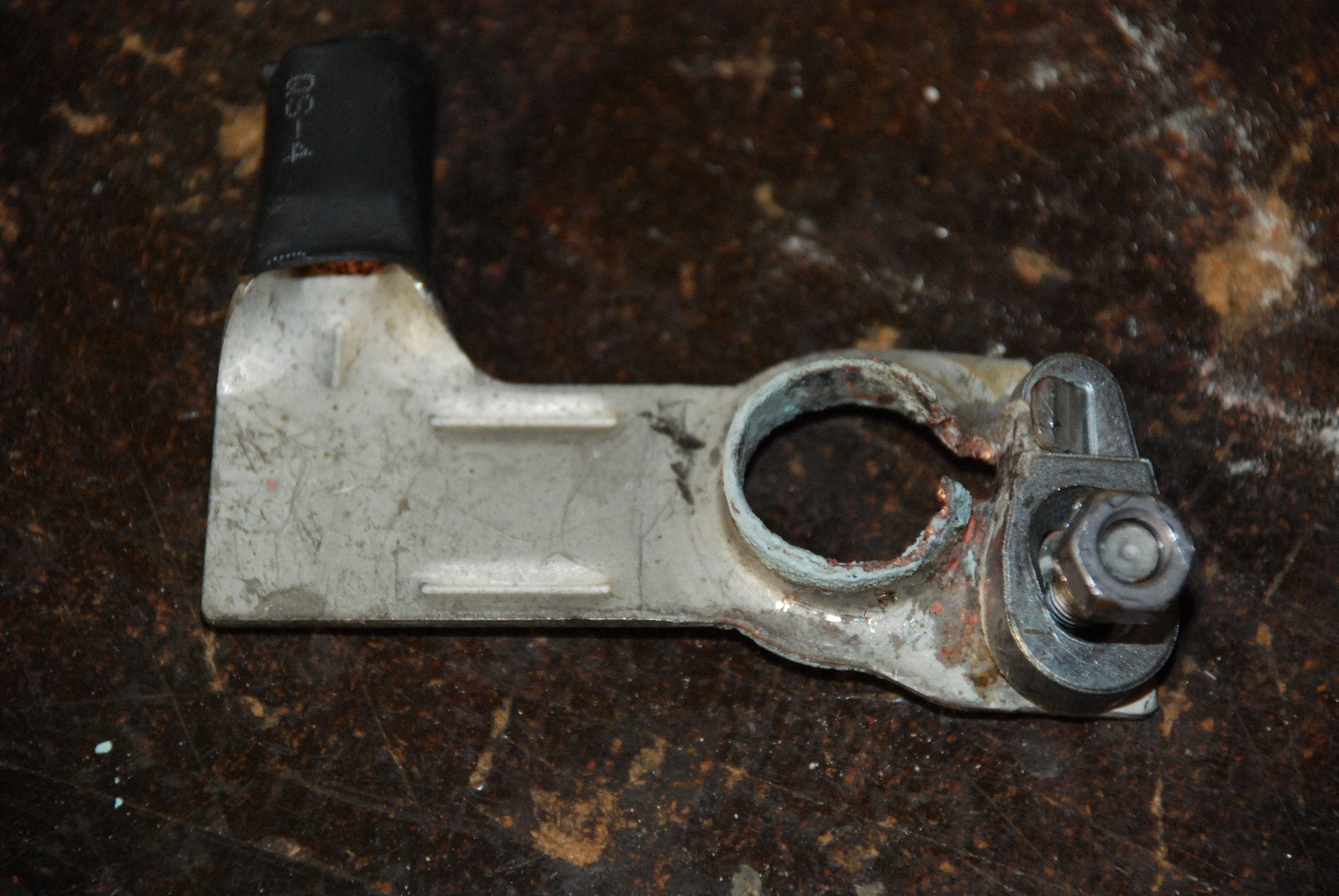

The terminals are not very secure. The negative one is original and has some funky clamp thing going on. I didn't look at it long but it didn't make sense that the tightening nut was on the top of the clamp.
Not mine but this is the style.
Yea, that's a C6 negative cable alright. The positive (red) terminal is similar, but has a red cap that snaps down over the terminal. Here is a picture. The nut you see in your photo is convex on the bottom. As you tighten that nut on the battery stud, that nut, riding in a concave portion of the clamp, effectively draws the other "half" of that split clamp toward the battery post, thus clamping tightly around it. Your best bet is to search the internet for a replacement set of cables. Easy to find and install. They are not that expensive either for what they do. As for the parts store guy plugging something into your port, I don't know what he was doing. I too have replaced a few C6 batteries and have never set off an alarm such as this guy was trying to prevent, I guess. Also, I have never had to re-index my windows after battery replacement. For some reason, some C6's windows will not work right after battery work and the windows have to be re-indexed. You can read about this in your owner's manual. About the only thing I have had to do after battery replacement is to reset the AM/FM radio stations, but there is a work-around for this too.
