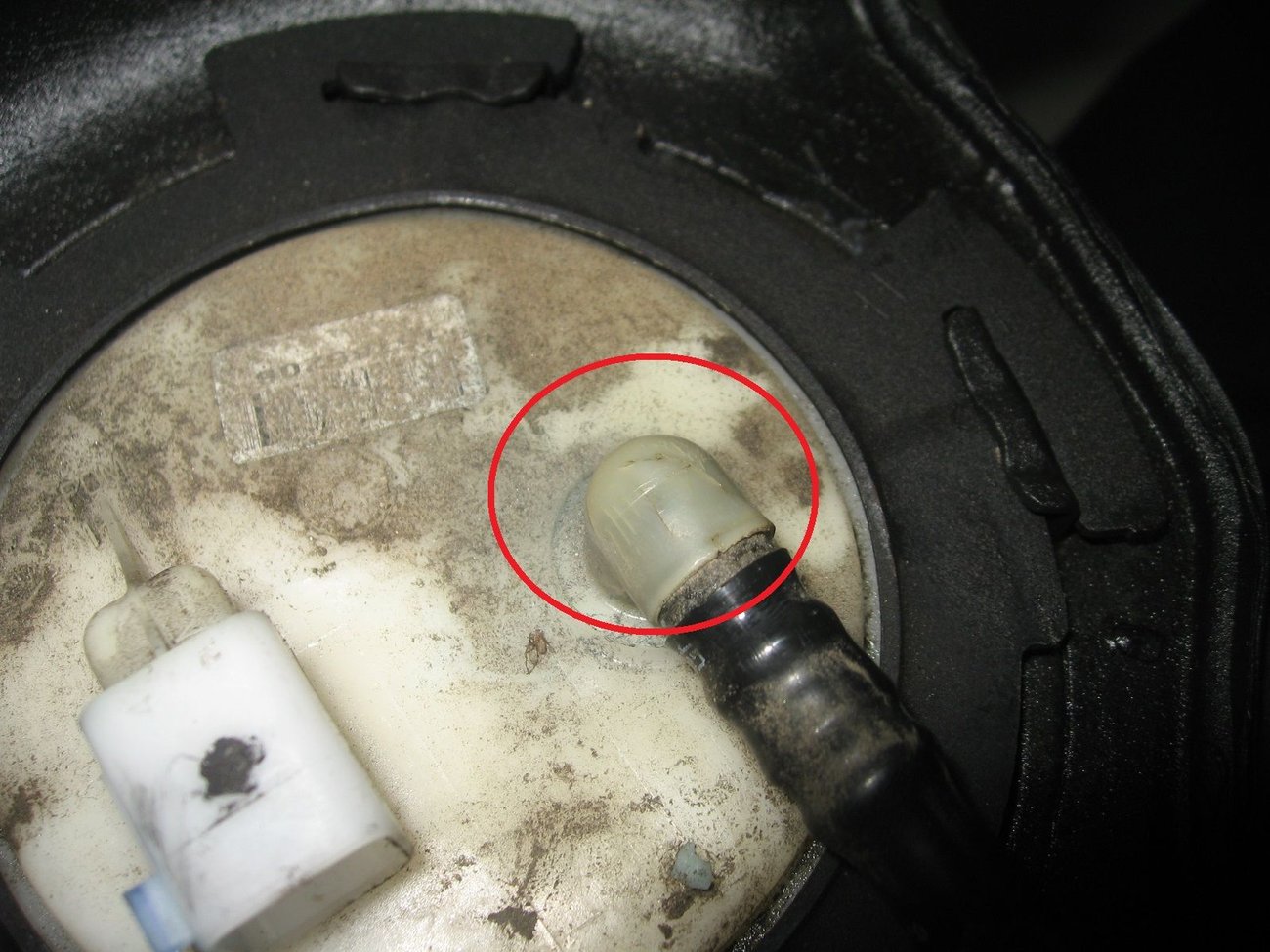

Biggest problem with the stock pumps, is the plastic top hose fittings that will crack over time.
So yes, can get a LS9 fuel pump on the cheap that will flow enough, but we are back to the plastic fitting problem over time isntead.
On the other hand, Lingenfelter has solve that problem in a SSR LS9 fuel pump that will cover you up to about 700hp, that has steel fittings isntead.

That's what I'm dealing with. The dreaded fuel smell. So I'm going to replace the whole bucket.
