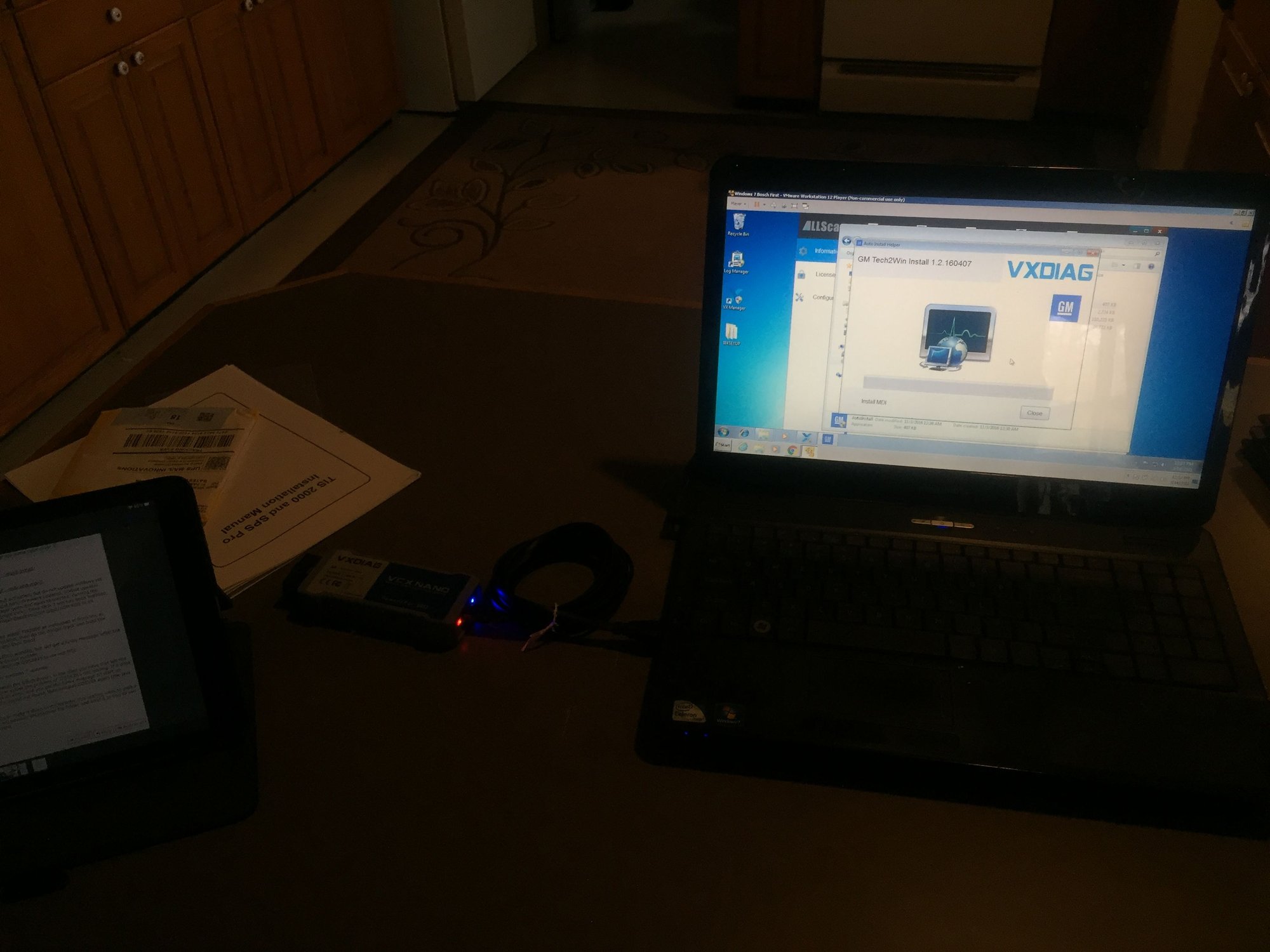

I have spent days trying to install TIS2000 on a virtual clone of Windows XP so I can flash updates to the modules the Tech2 says are staying awake.
Unless someone here knows how to get VX Manager to run in a 32 bit, Windows XP virtual environment, I’m stuck. The install file (VX Manager 1.8.x) won’t even open, just says it’s not a valid Win32 application.
If no one here knows how to get it to work via internet downloads or DOS Prompt trickery, I’m going to have to break down and buy the 3CD set and the dongle that will let me run TIS2000 from Windows 7, and not a cracked version on a virtual XP machine.
Edit: I have ordered the CD and USB key, but it won’t arrive for two months (by Mar 25) from China, sooo... Still down for any help anyone can give me.

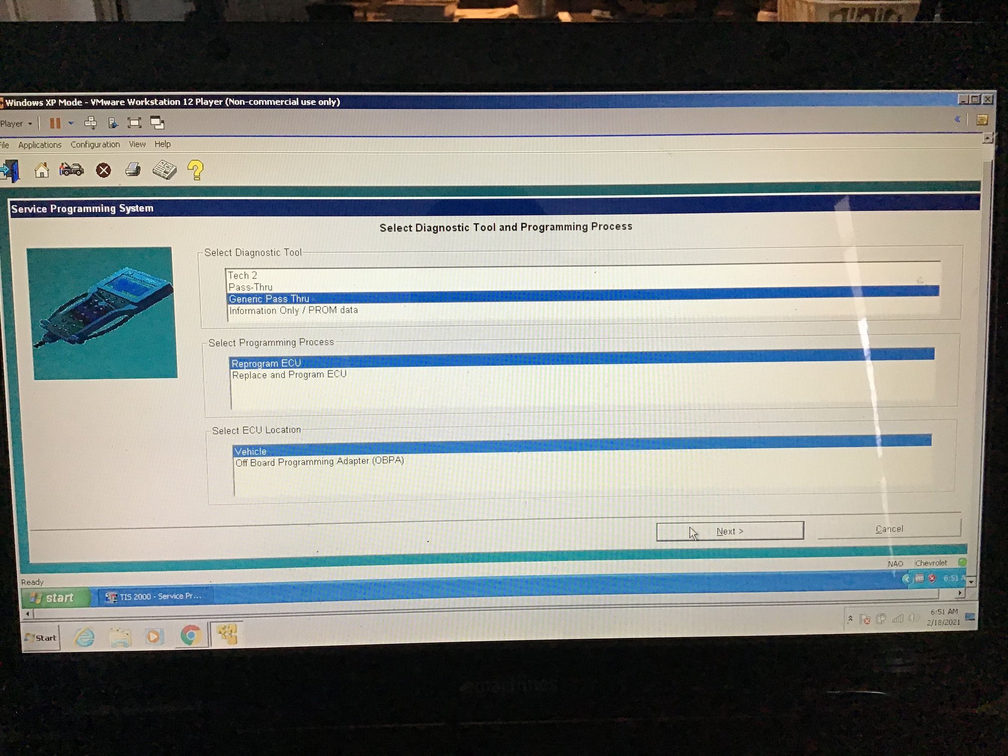

Test run:
XP VM shell is open.
Nano is connected to the shell.
Open TIS2000 and select SPS.
Select Generic Pass Thru Device (the Nano driver I built) and hit Next.
Build the car’s profile and hit Next.
Connect to car, but we are in the kitchen for this dry run, so click Next.
First error message is about Pass Thru license. Clicked OK.
Second error message is the one you said I should see, about the ECM being a service model. Clicked Next
Asks me to verify the VIN, so I canceled at this point. I will go outside and copy down the VIN and try it again.
Update after Vin:
Entered the VIN and clicked Next.
It’s the module selection screen you mentioned.
If I click on a module, I get options. I just chose the default Normal for this test run. Clicked Next.
Error message about Pass Thru license. Clicked OK
Error message about no communication with vehicle. Clicked ok and closed the program.

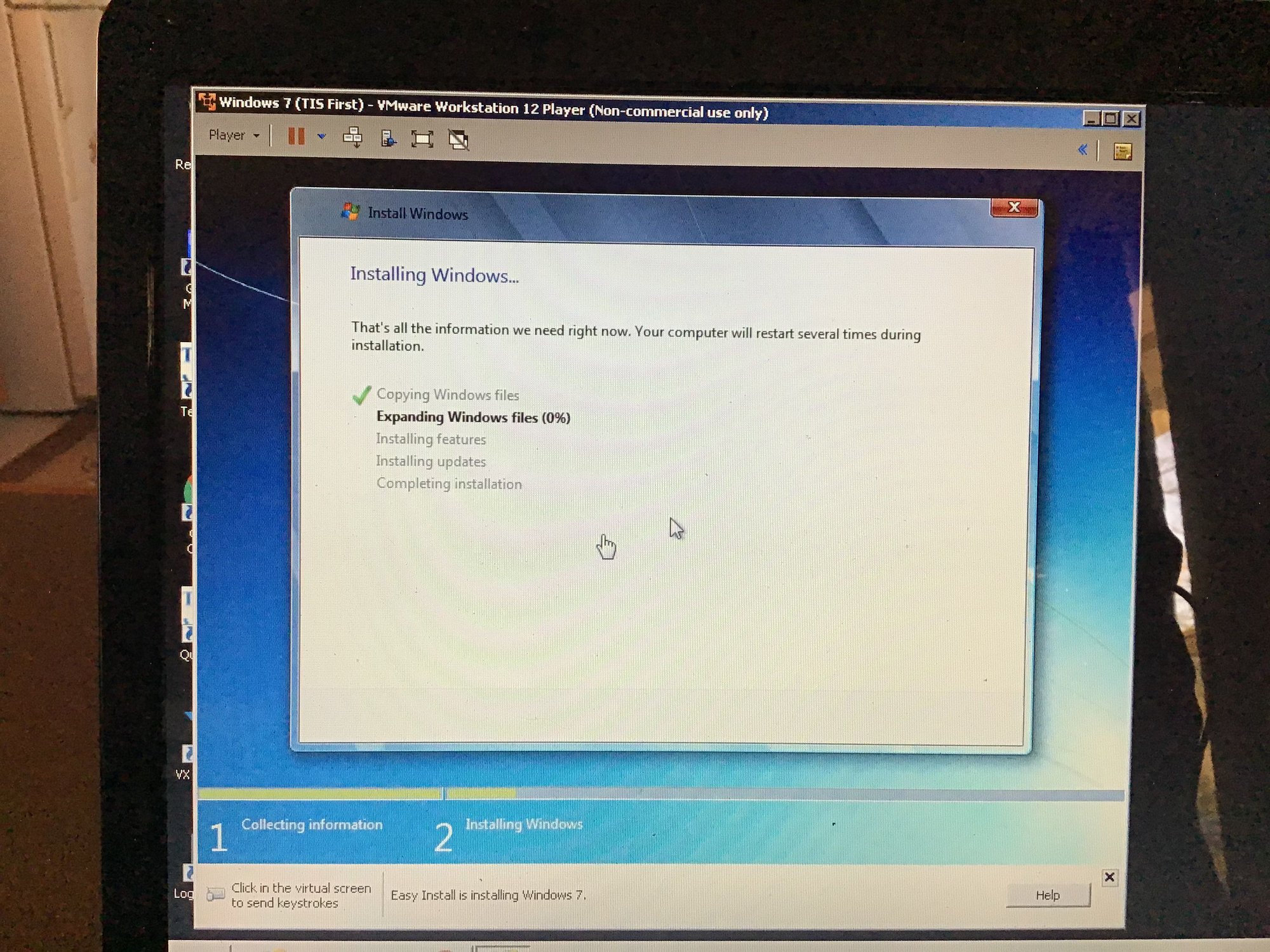

Here for our weekly installment of “How to Setup the Computer”.
I seriously feel sorry for anyone who gets a C6 about two years from now, because the computer hardware and software required is getting so old that it’s hard to find, and even harder to get running once you find it. The laptop is going to have to stay with the car, if you have one and you’re selling it. Don’t leave the next guy in the hook, make sure the dedicated laptop goes with the C6!!!
Right now, I can get VX Manager to operate only in a Windows 7 environment, and the TIS2000 will only work in the XP environment. The VX Manager in the XP environment will no longer update the licenses, so you can’t install any of the Passthru software. It is a nightmare trying to figure out how to make the two connect.
Anyway, here is the list of installation steps I’m following this time around:
And here’s what happened:
Clean installation.
Windows 7 Enterprise in Virtual Machine.
Install VX Manager first.
Installed without any additional licenses.
Had to upgrade C++ Runtime to play the VX Manager file.
Updated firmware and license.
Installed Tech2Win with Nano still connected.
Installed Passthru
Installed GDSS2 and SDS.
Ran the Bosch drivers program.
Installed TIS2000
Ran the crack.
Did not solve the problem.

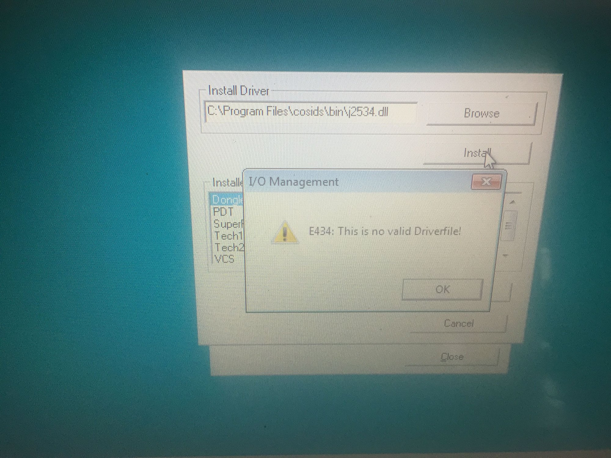

TIS2000 refuses to recognize J2534.dll as a valid driver file in Windows 7, but works perfectly in XP Pro.

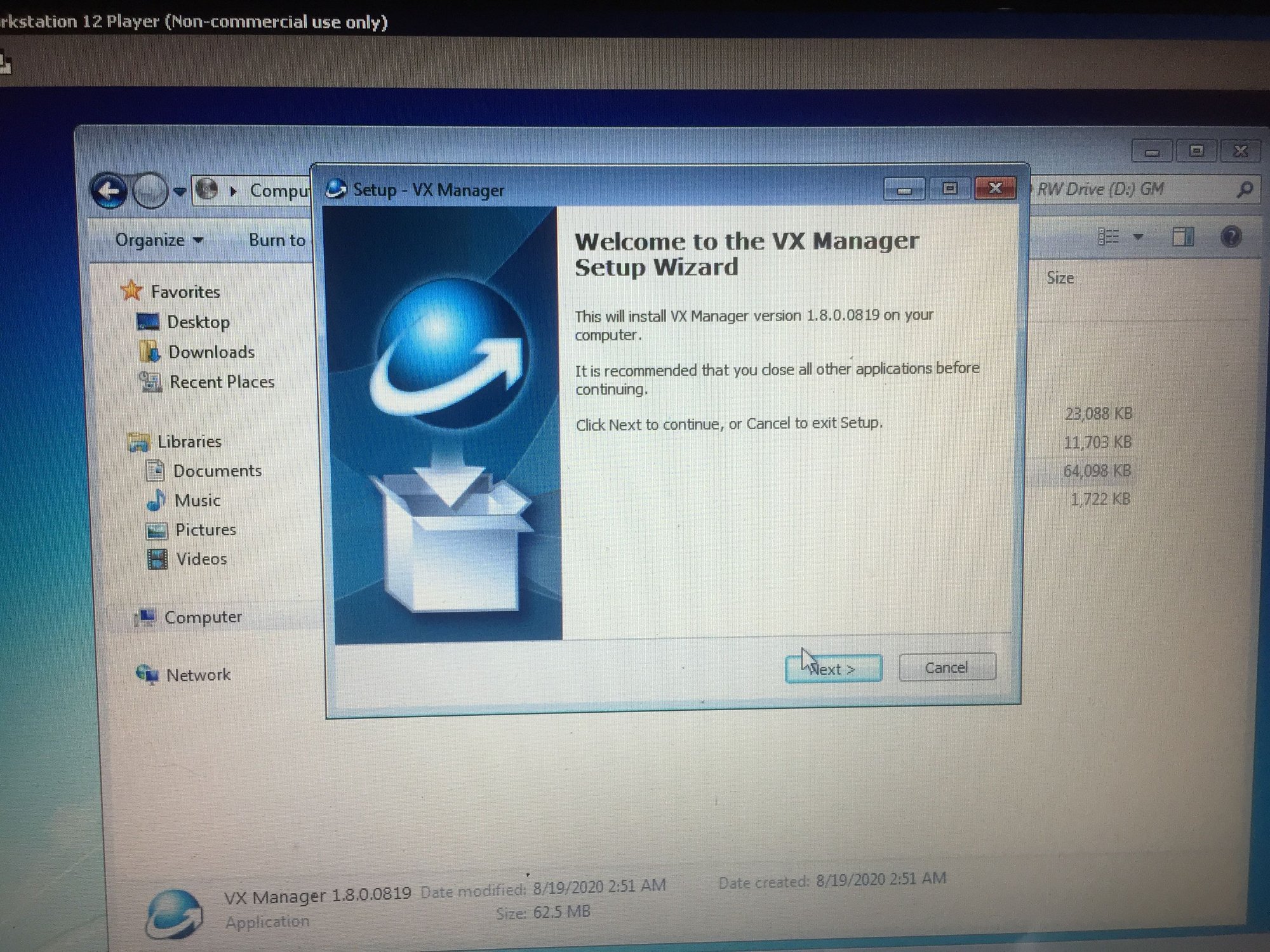

Install VX manager in the shell, get the nano firmware license updated in VX manager, then Tech2 win install using Autoinstall.exe from the tech2 win folder with VX open and Nano connected, so you can install pass throu, GM gds2/tech2 win, sgm rds VX apps within VX manager only.
Note, we install everything as admin, including the VX manager to start.
Now install Bosch drivers from the link, then NAO Tis2000 disc 1 as VM cd/dvd select from main OS , do the cracks with the Crack folder decompressed in the VM shell (not in the main OS still), go back to VM tools and switch CD/DVD to Tis200 disc 2 to open tis2000 and update it, then same the Tis2000 disc 3 update as well.

So again the problem I am seeing, is that you are trying to install GDSV19 stand alone program fro the GDS folder first since I can see the GDS icon in the desktop, then TIS2000 after that, and what is causing your problem. Truth is, the reason that we install the stand alone GDSV19 at all in the end (over than just having it), it will solve the device number not found pop up on start up of the VM shell from the Bosch drivers in the first place.
Your getting this, since when you built the VM shell, either did not add a parallel port device as hardware in the shell, and/or did not check the parallel security upper box in TIS2000 first set up on disc 1 before you run the Dll crack and install the needed files.

Start with fresh VM win 7 32bit shell, activate it and make sure to install VM tools, then install Bosch drivers and TIS2000 first (disc one), do the crack, then update Tis2000 with disc 2 then disc 3, then build the Nano driver in Tis2000.
On your machine, Got a feeling that installing VX manger 1.8 before Tis2000 is screwing something up as VX manager changing some of the software around.
This should give you the TIS2000 J2534 pass through in device from the J2534.Dll that is the hang up now, to install the Generic pass thou driver for the Nano and use the J2534 pass through in the driver window of it properties.
Once Tis2000 is golden with Nano driver, Then install VX manager 1.8, T2w with VX open and nano attached, the three VX apps that T2w will allow to happen, then GDSV19, and you can then update windows in the end.
And like always, always install everything as admin.

Fresh install.
Copied over KMS, GMNAO2000 and the crack, and the GM MDI Manager setup.
Installed TIS2000, selecting parallel port.
Ran the crack.
TIS 2000 is installed, installing GM MDI Manager.
Manager installing.
Manager still installing.
Manager is finished.
Building the driver in TIS 2000.
Same dead end. TIS 2000 doesn’t recognize the driver.
