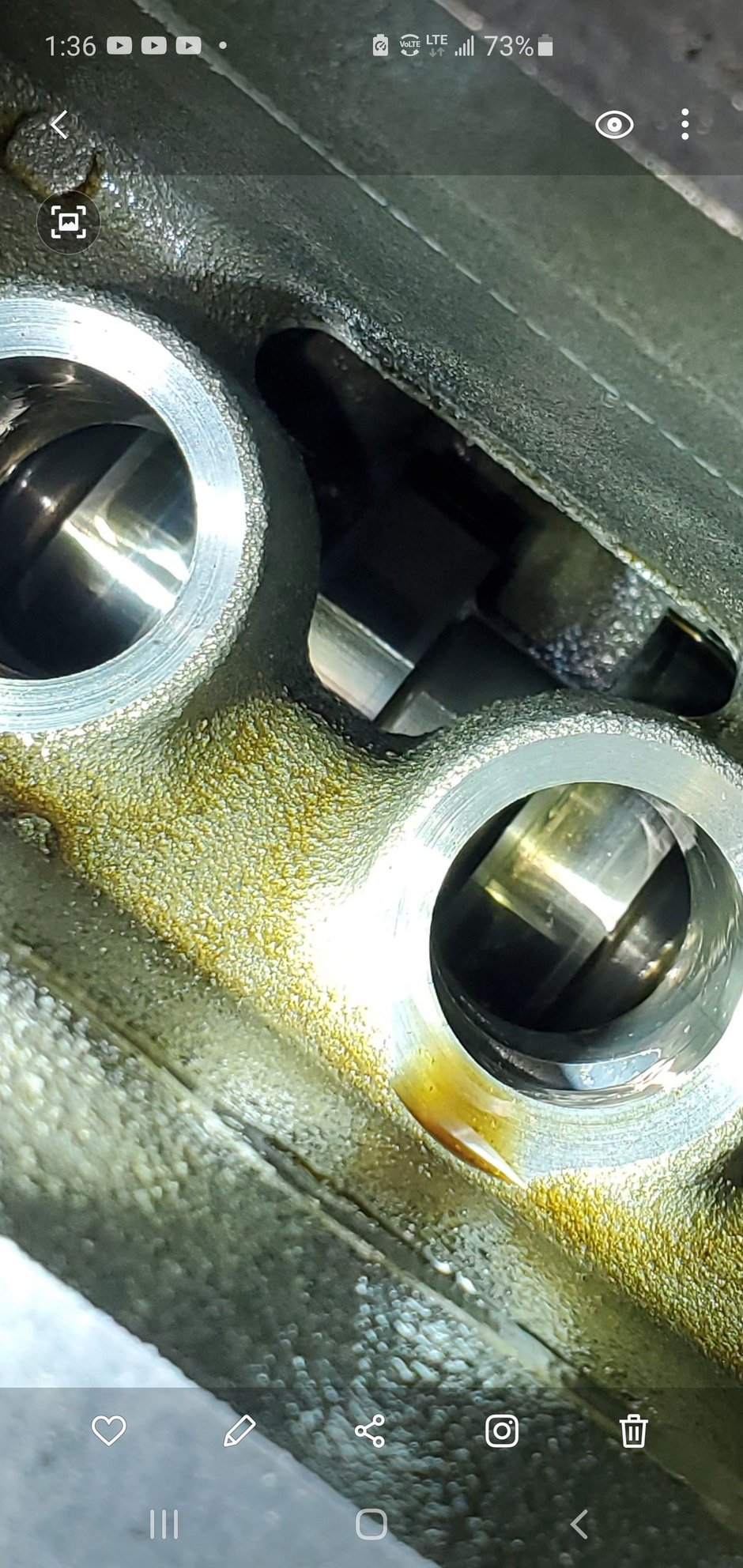

no good ....

Cam is toast. What springs are you running?

The Pac racing Spring 1.270" OD Hydraulic Roller Dual Valve Spring, 155 lbs. on seat,

Time for a new cam and lifters.
Could the copper and tin be from the rocker bushings (assuming they are bronze). Probably not a bad idea to check them.

yep fubar....
stock 74k mile cam...

I have seen this a number of times on cars with aftermarket cams. Is this just inevitable when running a larger, non-stock cam? Or is this because of improper lubrication, etc.?

I am no expert, but since a lot of folks are running pretty big aftermarket cams with lots and lots of lift, they also need double valve springs capable of .660" lift and lots of valve seat pressure and valve open pressure in order to keep the valvetrain stable at high rpm.
I am convinced that these very stiff aftermarket double valve springs are playing hell with the cam lobes.
Just my opinion ...

Turbo6TA could be spot on along with possibly bad harmonics caused from the OEM geometry

But these LS2 and LS3 C6s that are left basically stock (at least stock as in stock cam and valve springs) don't have there cam lobes and/or valve lifter rollers all chewed up like you keep seeing in guys that have non-stock valve train components.
Of course, if a wore out lifter tray causes the lifter to rotate, it will certainly take out cam lobes ... but there are lifter trays in internally stock 100,000 mile LS engines that are still holding up fine.
Additionally, if harmonics caused by bad OEM engine geometry was at fault here, you would be seeing lots of stock cam LS engines destroying cam lobes and lifters, but that's not the case.
True Turbo6TA but in my case I'm talking about OEM used in aftermarket AFR Mongoose

..... but then there's always those guys running stock OEM rockers @ .650" lift shifting @ 7K rpm having no troubles at all !
No problems initially ...

Since it looks like most of the lobes are messed up, it could be improper heat treating of cam too

Lots of things play into whether an upgraded valve train leads a long and happy life or goes **** up prematurely.
Camshaft lobe style is just one them. Just because the lift is higher than stock doesn't mean early valve train failure is inevitable. Some of the earlier lobe styles were definitely harder on parts. Newer ones are definitely easier on things as long as you chose components wisely. Aggressive ramp rates and high lifts along with the higher pressure springs needed to control them aren't good for longevity. They may get you to the finish line quicker, but that extra performance comes at a price.
Getting the valve train set up correctly is just as important as quality of parts.
Good quality lubricants and early oil changes can sure help too.

did you tear into this to inspect the cam for a reason...or just upgrades/ maintenance?

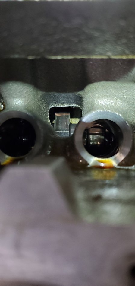

#1 what do the lifters look like? # 2 in the large photo's looks normal to me if you thought that a steel wheel running on a lobe wasn't going to leave some sort of mark, your delusional.

Dude wtf are you trying to say? that this normal? I've got motors with solid rollers & over .700" lift that DON'T have any marks or pits on them.

I wish I had the magic recipe to make things right for you. You're on the right track with the lighter valves if you're going to spin it hard. Pay close attention to lifter pre load and measure them all. I've heard of folks needing 6 or 7 different length push rods to get them all within spec. Peons like me...eh, if I'm close, I'm probably good. I have a fairly tame cam on soft lobes and rarely and go north of 6800 rpm. More RPM demands more attention to detail for sure.
