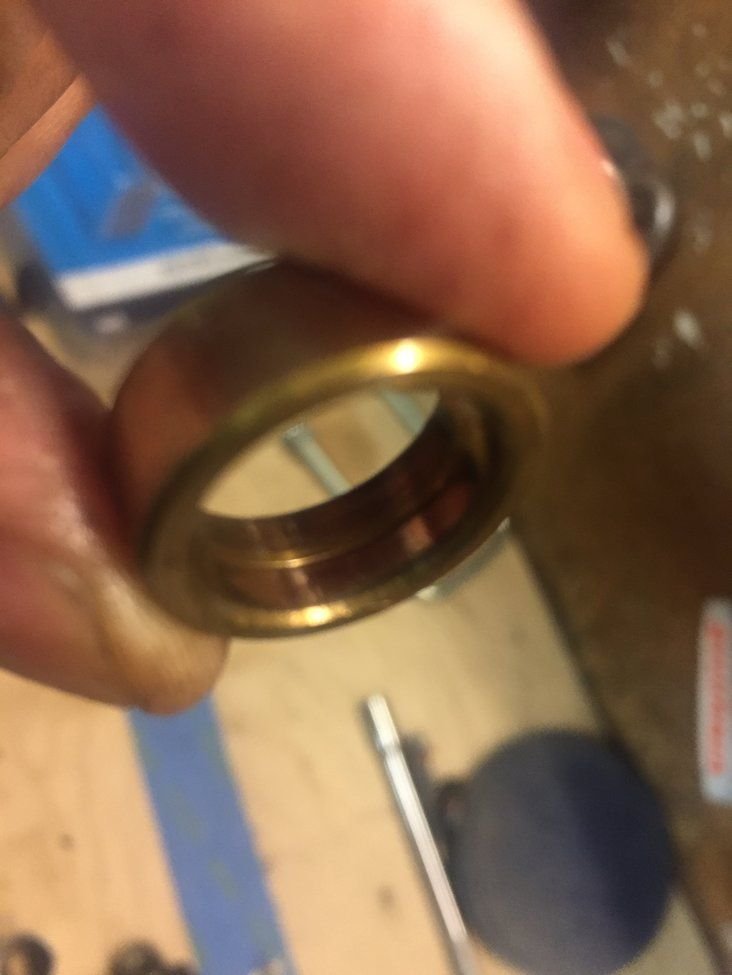

Too bad this is what my CHE look like after 7000 miles.
Every single one was scored and worn.

That doesn't look like CHE, looks like one of the other brands

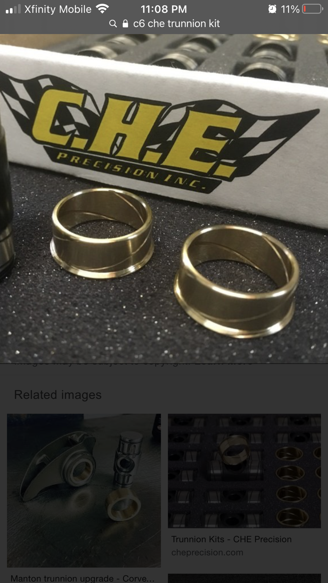

I agree the CHE bushings look like this...

It also is not Comp Cams.
I have the DIY CHE rocker arm trunnion upgrade too, but CHE once did their own bronze bushing upgrade where you had to send your rockers in.
Maybe it is that?
