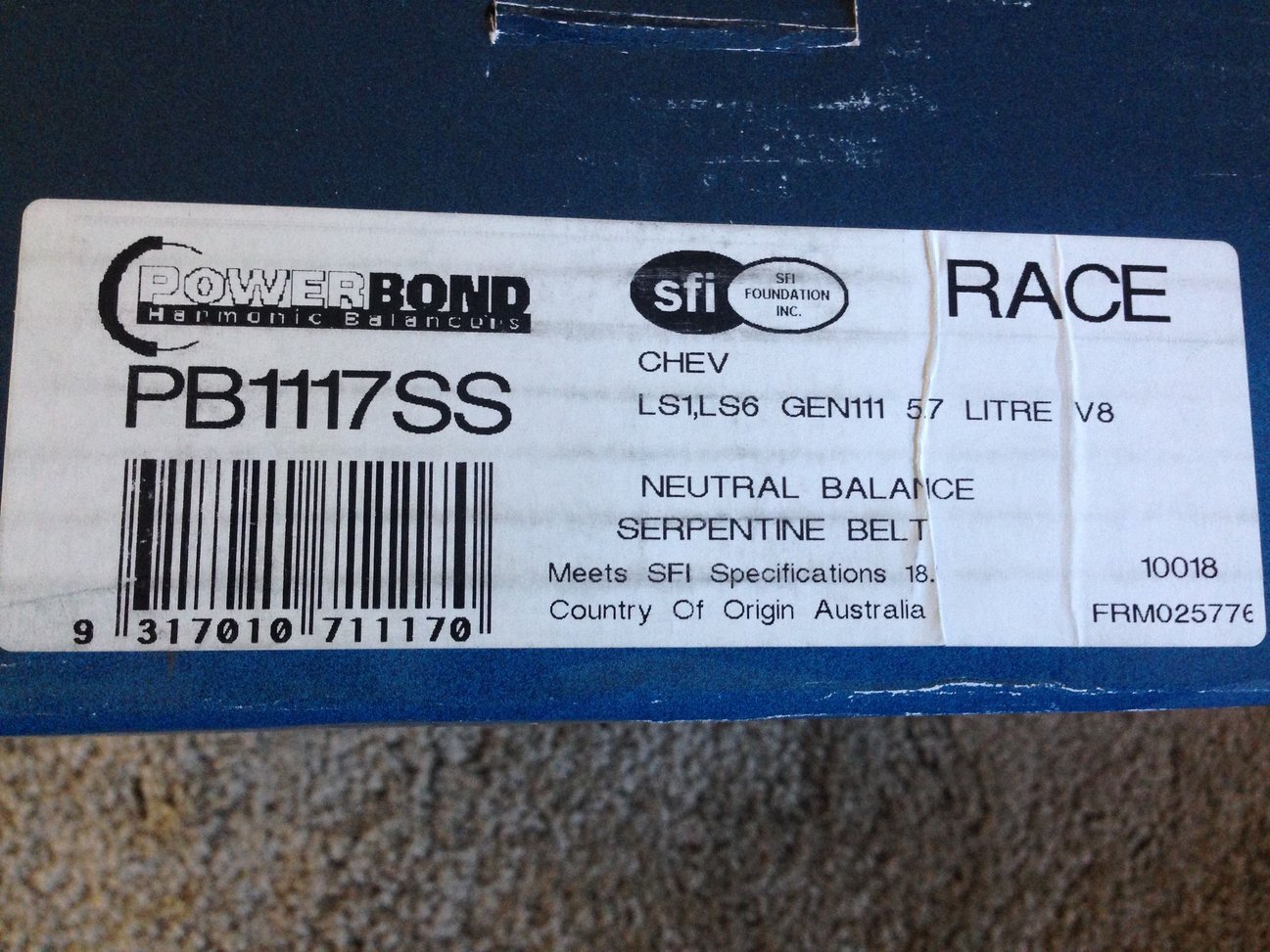

Call Dayco. 800 848 7902. 2008 LS3 Powerbond PB 1117SS is what I used and pinned it. Do not reuse the friction washer from your OEM balancer. Not required. A6 wet sump.

https://cimg3.ibsrv.net/gimg/www.cor...e36afd73a3.jpg
that's for LS1, LS6 Gen3 according to this.
Go to Summitt website and type it in.

Does not specify if this fits dry sump LS3.. Old Motorhead specified HB that fits 7.0L (also dry sump) PB1503SS. Read 6 posts above. Thank you

Didn’t one of those also say that Dayco Powerbond does NOT make a balancer for dry sump ? What do you have, what year, LS3, LS7, wet or dry sump ?call Dayco tomorrow and see what they recommend.

yes! that response was from Dayco support. Always triple check.

As noted, you can not rebuild the Gates 'PowerBond Race Performance' balancer, but you won't ever need to ... because they don't fail
LS3 Wet Sump: . . PB1117SS
LS7 Dry Sump: . . PB1503SS
