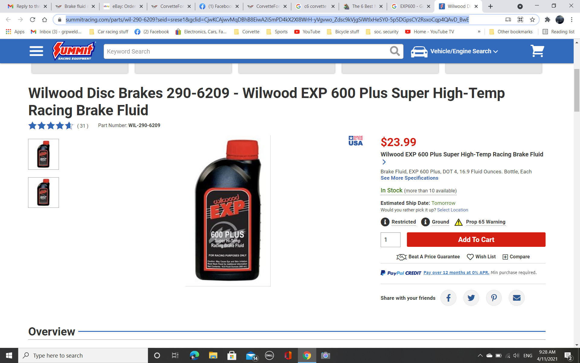

Old Apr 11, 2021 | 12:36 PM
grpweld's Avatar
grpweld
Joined: Feb 2017
Posts: 611
Likes: 79
From: Fallbrook SanDiego county
This is the best for what you are doing
https://www.summitracing.com/parts/w...xoCqp4QAvD_BwE
