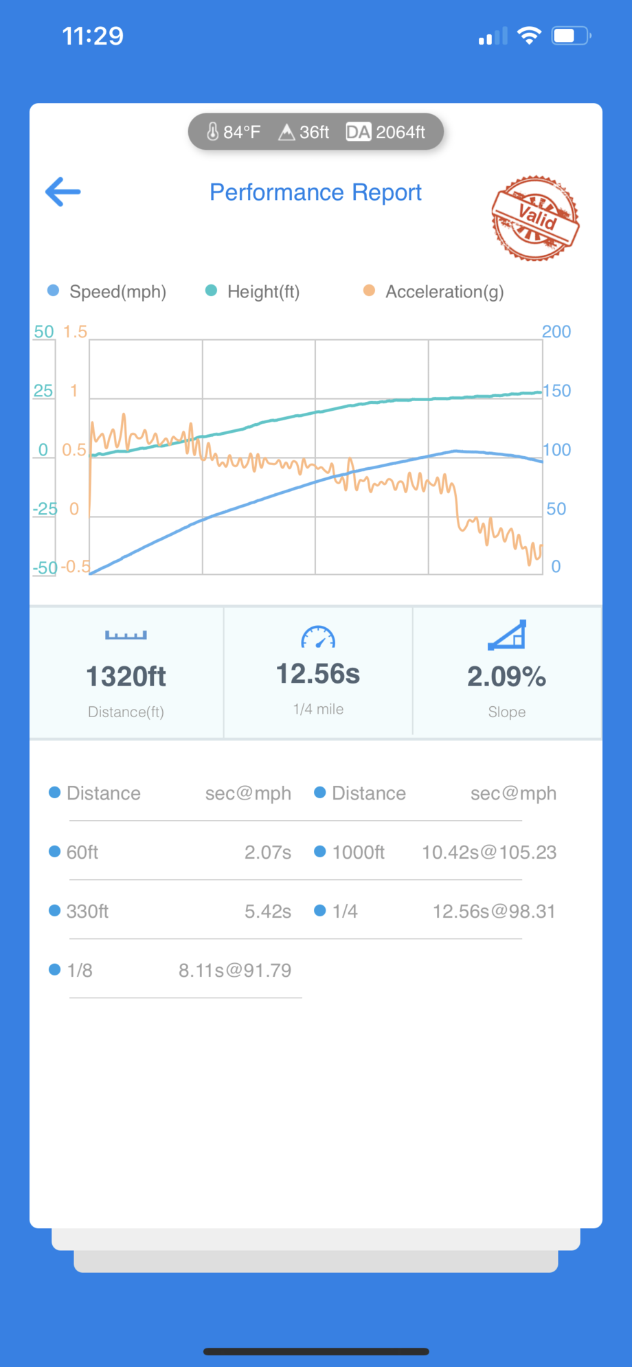

Man I really hope this isn't the case. I took the car out on my dragy yesterday (track was closed for weather) and my best was 7.8 @ 94mph eighth mile. There is No way I can make up almost a full second just based on track/street conditions...still really no change. I realize its the street and I'm on drag radials but I still feel like the car should be dipping into the low 7's even with a small amount of tire spin off the launch. Taking the car back in this week. It's really getting depressing. FML.

7.8 is about a 12.15 1/4 mile (using the common 1/8 to 1/4 calculators) You should be WAY quicker! Your car should be high 10s on a good tire. I would start to look at something mechanical.
Where do you shift at? You probably have the stock, long runners in the FAST intake which are good for low rpm. You can get the grey medium runners and they will shift the powerband up 300-400 rpm. When I had FAST medium runners in a similar sized cam motion cam, I was shiftimg around 6900/7000 rpm.
I would take the car to a 3rd party dynojet dyno and get a baseline. I would also have a 3rd party tuner to look at the the tune up.
I would also verify that you aren't one tooth off on the cam gear. There IS a way to do it without tearing the engine down and without a cam degree wheel. You basically compare the rising vs dropping valve springs on the #1 cyl as you near TDC (obviously with the VC off and springs exposed) while slowly rotating the engine. It is EXACTLY how I realized that I timed my cam one tooth off--after following this method, I tore the damper and front cover off and SURE ENOUGH, the cam was mounted one tooth retarded! Let me see if I can find and link the article for you.
