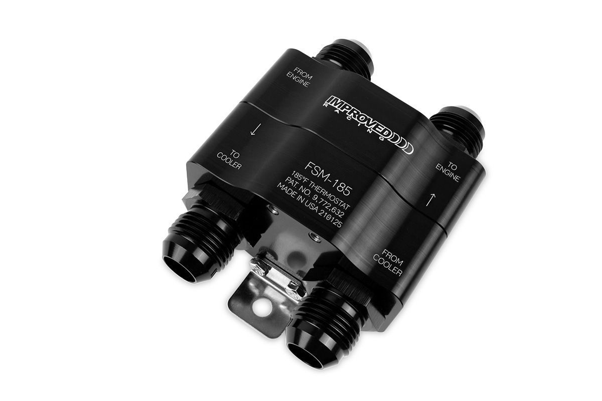

Install a fluid thermostat that bypasses the cooler until the fluid reaches a predetermined temp... then it opens allowing the fluid to go to the cooler... this will help promote quicker trans warm up temps then stabilize the temps once reached.
I have run these both on the transmission & Oil systems with their own dedicated coolers that had thermostatically controlled e-fans... When used together your engine and trans temps will remain remarkably stable and literally assist the coolant system with cooling duties.
