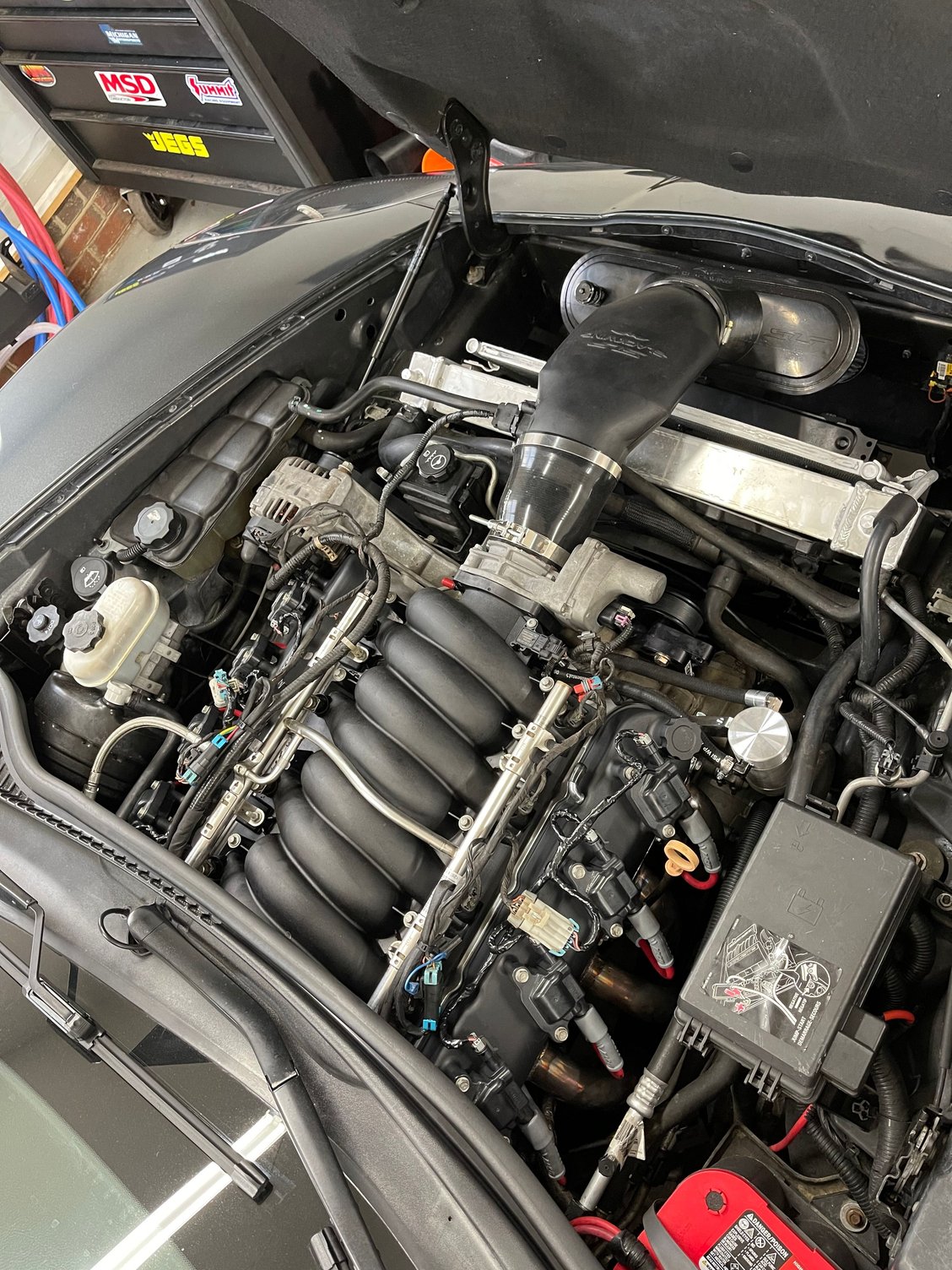

I have a 13 C6 that is a full build of Heads, Cam, Intake. The heads are Gwatney 281cc ported, the intake is the Gwatney Rod-mod ported ls3 manifold, and the cam of course is the Texas Speed F35 Stage 4 Camshaft. It has a random misfire/breakup at 1700-2100rpm when over 75% throttle. It is only at this rpm. I have changed the coils, plugs, wires, crank sensor, MAF, and map sensor trying to find out what the issue is. My AFR gauge is reading a great 13.9-14.1 afr’d during the breakup with no change. Can ANYONE HELP please with this situation? Is it simply because the cam is to big? I have had 3 dyno tuners tell me all the same exact thing.

I am from Statesville-Mooresville area, it’s not throwing any misfire codes due to the cam being so large it’s impossible to use this data. It 100% is very noticeable, as in you can audibly hear it and it will physically feel like a breakup/misfire. Again only at 75-100% throttle from 1700-2100 rpm. I really think it is a turbulence issue possibly. I had to remove the accordion style throttle body couple and install a smooth boot in its place so I’m curious if this may have caused some turbulence. Very strange issue that no tuner has yet to be able to answer. All tuners have been big tunes for NC and all say the same thing about the cam. We just recently noticed the MAF data is quite wild at the time of it happening and I can’t help but wonder if this is possibly a issue. During the stutter/breakup the car is keeping good AFR’s so it’s very conflicting.

what intake do you have? Have a picture of your maf placement?
Old Feb 2, 2022 | 04:26 PM
Lucas_C6's Avatar
Lucas_C6
Joined: Jul 2017
Posts: 35
It is a SLP Blackwing intake

I have had 2 sets of MSD and one set of Taylor Cables. You aren’t bothering me a bit, but there isn’t one single physical part that hasn’t been tested or replaced. I’m thinking the MAF is my issue due to turbulent air would be my guess now. I am trying out a Vararam intake tomorrow and see if that changes it. It comes with a MAF housing and all new boots and supposed to smooth everything out.
