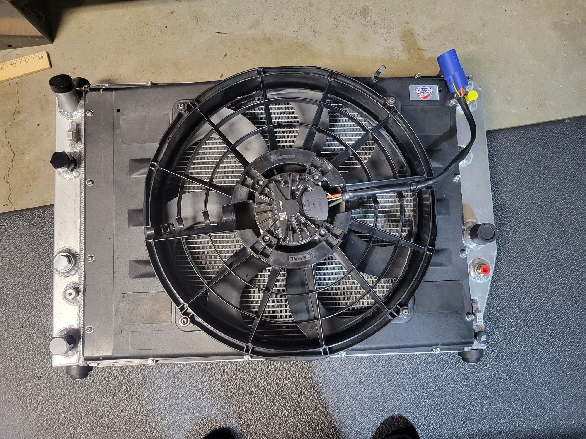

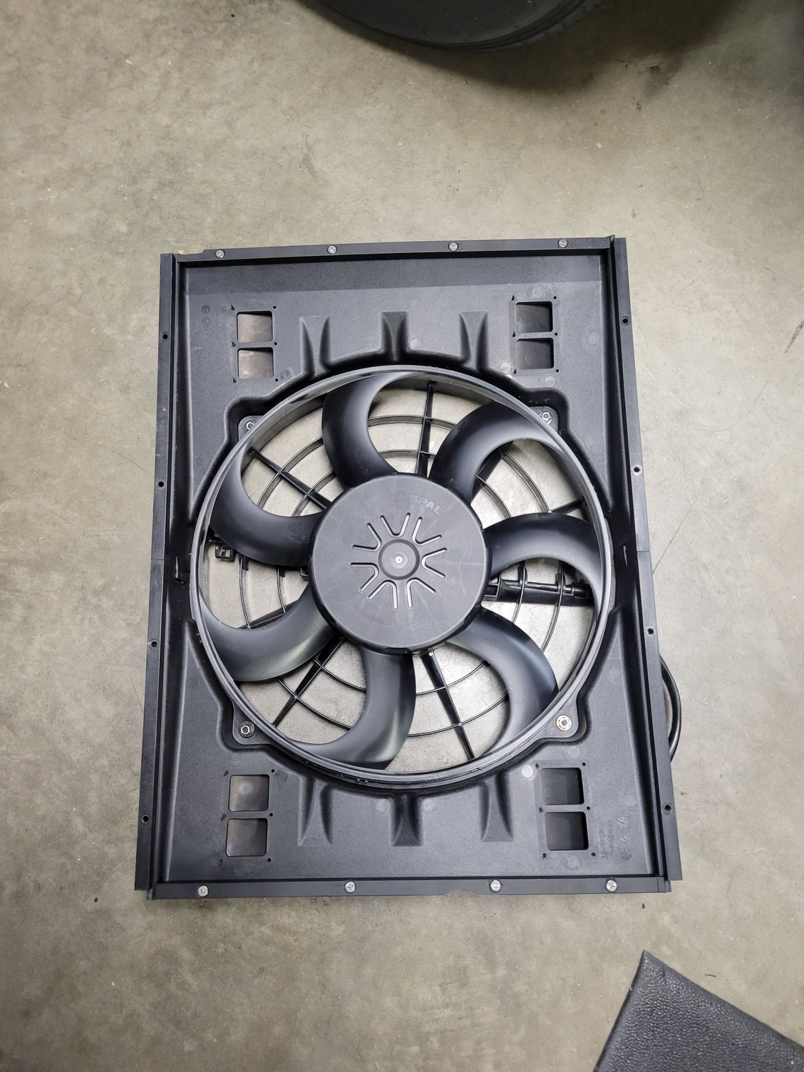

Or you can go brushless which has its own PWM. That i
s a Dewitts custom shroud and 500 watt brushless fan. It is a Mishimoto radiator as it has a 17.5 inch tall core with top/bottom tabs (18.5 inches) that allow the shroud to be installed as shown with a Dewitts radiator you would need to make a bracket (as the core is like 16.3 inches high with no tabs and you need an 18.5 inch bolt to tab height. As someone mentioned you fix one are another are becomes an issue. The bottom photo is the final as it has the wire in 3 o'clock position and I ended up have to cut some more on passenger side and move over to miss the ABS box. In hindsight you leave the drivers side of the Dewitts shroud alone (to bring fan far enough over to miss ABS) and cut at the line and bolt a 1/2 inch square 17.5 inch nylon bar to it to block off air coming in. Normally these shrouds have a turn down on the sides to prevent air coming in from the sides. The shroud itself is like 27.5 inches and we only need 25 inches so that is why you cut the one side off.

That is why the shroud has 4 blow off tabs - one in each corner. So when there is a lot of air flow at least some gets by the fan.

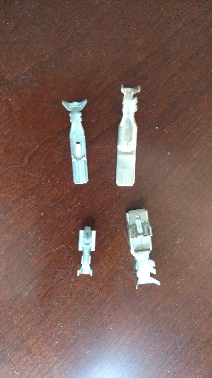

If you go connector - go Metripak 800 what is in car is Metripak 630. The 800 series can take like 50+% more current - see photos below and see the difference. Basically the 800 is about the size of a house wall socket.
