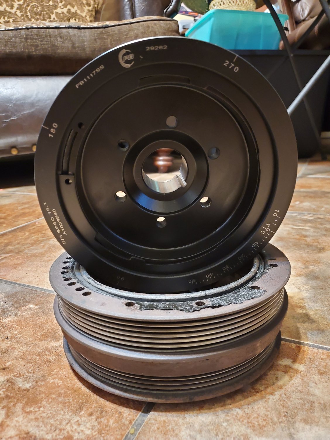

Another long shot but good practice to do so anyway. When my harmonic balancer crankshaft pulley was really wobbly and on its way out, my charging system was acting funny too.
Contrary to popular belief, I believe a lose balancer can cause these things. Many don't think so and I've been told otherwise on my own balancer thread. When I changed mine it fixed everything. I got a Powerbond.
if a wobbly balancer doesn't cause charging system problems on these vettes then why do underdrive pullies cause some probs? Why could a bad tensioner cause pros? Maybe just MAYBE a wobbly balancer can have something to do with it. It did with mine.
My vette is an 08 LS3 BTW so check if an LS2 uses a different PN in case you do this as well and use Powerbond.
Goodluck!!

Hey Jaime thanks for the response. I had the death wobble on the balancer last year and replaced it this past october with a Summit Racing blaancer.. Everything worked fine. I did visually inspect the balancer and dont see any wobble or anything moving like it shouldnt. (I kinda check it all the time now cause didnt want a repeat of the wobble). Im really banging my head against the wall on this charging issue. Im wondering if the windings in the rebuilt alternator are bad. Im not sure what they when they rebuild an alternator, I believe a standard bench rebuild invoves the brushes, bearings, diodes and regulator. But something is telling it to either shut off at the 3500 to 4000 rpm mark, or the alternator itself just isnt functioning at those rpms. When everything checks out ok, im at a loss of where to go next.
