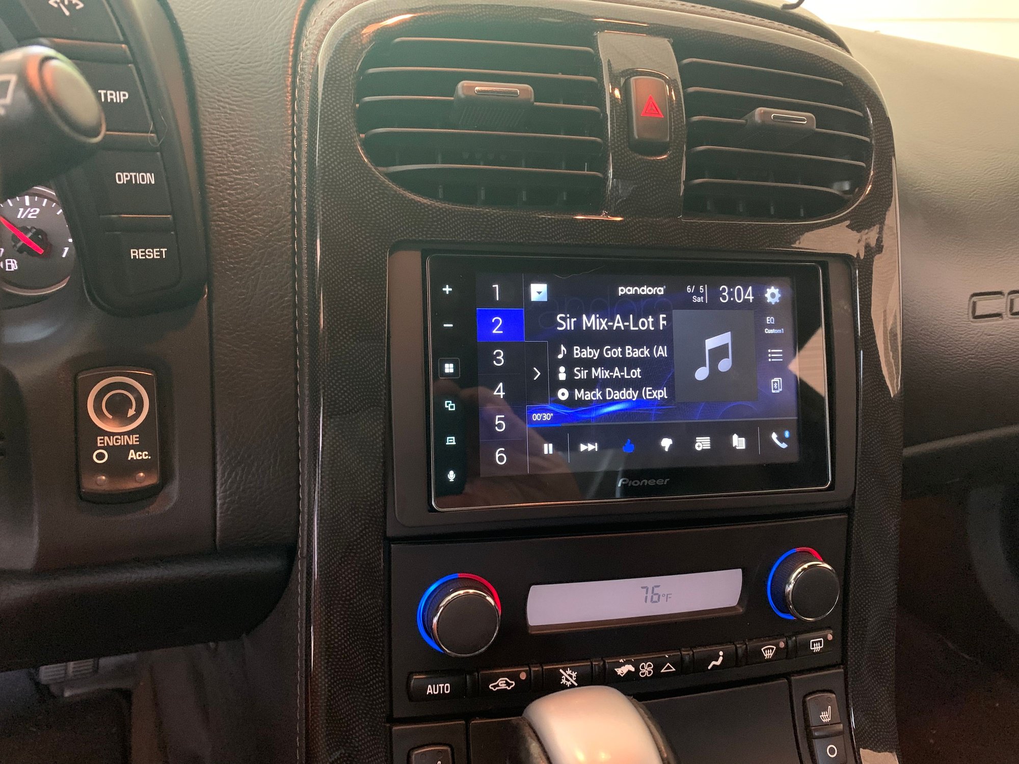

Vote for pioneer… why not go OEM??? Sound is 100% better with aftermarket and options that you think you would not use… you cannot see life without em.

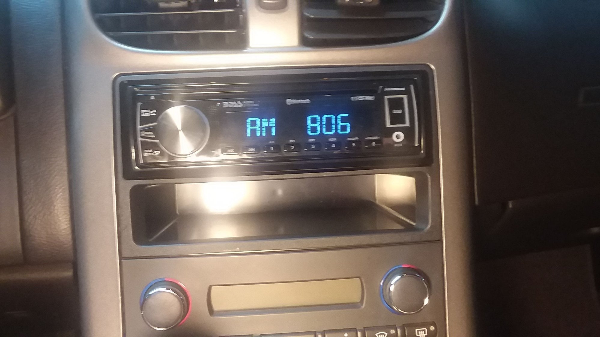

Dang Jim__H, I don't think I've ever seen a single DIN in a C6, previous owner must have been a real cheapskate. I wouldn't bother putting the stock head unit back in, it wasn't very good. Just do a double DIN good quality aftermarket unit.

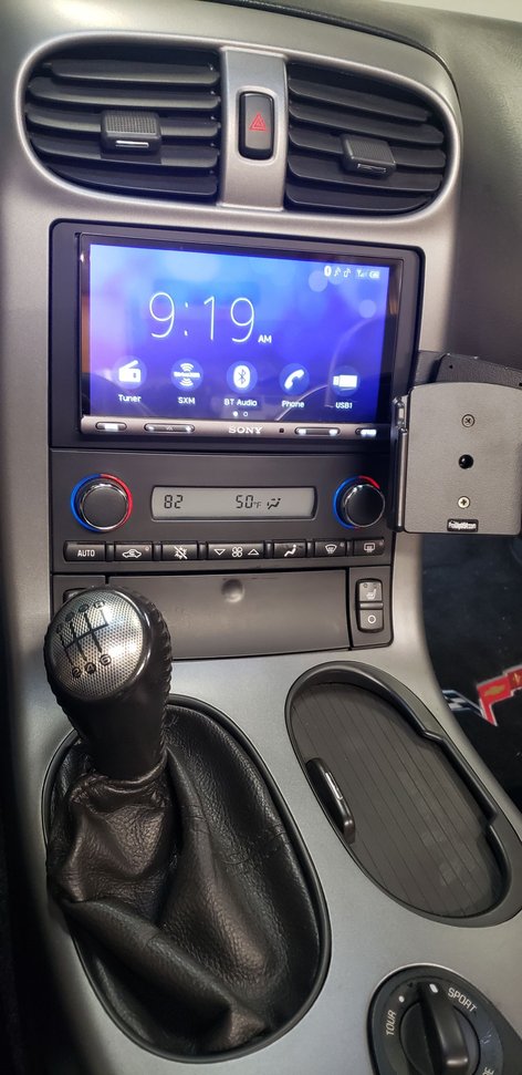

I went with a Sony XAV-AX5000 primarily to get Android Auto and Apple CarPlay. Added a back up camera as well. Best system, probably not, but it does what I need.

Blown,
Sorry to give ya bad news but you might wanna redo that double din. I had to do this myself 2x before it was right. Your center console stack isnt sitting right. You can see the console is interfering with the double din adapter. You have to move the HVAC stack a bit more down, move the double din a bit more down, and the console will snap in place perfectly.
Mark the double din adapter how much lower you have to drop it so you only have to do it once.

This was my first pic after install and I seen it.... will post after pic.

His adapter bezel is installed upside-down. The edge with radiused corners is supposed to be on top.

Bingo...... Figured it out and have it like it should.
