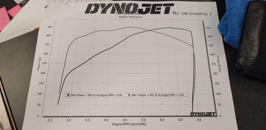

Dyno on stock cubes with stock correction:
Dyno using STD correction smoothing 5 Stock cubes 6.0 same exact bolt ons.
Dyno using SAE correction smoothing 5 On the 408 stroker setup. Same bolts on and cam as 6.0 setup just more cubes.

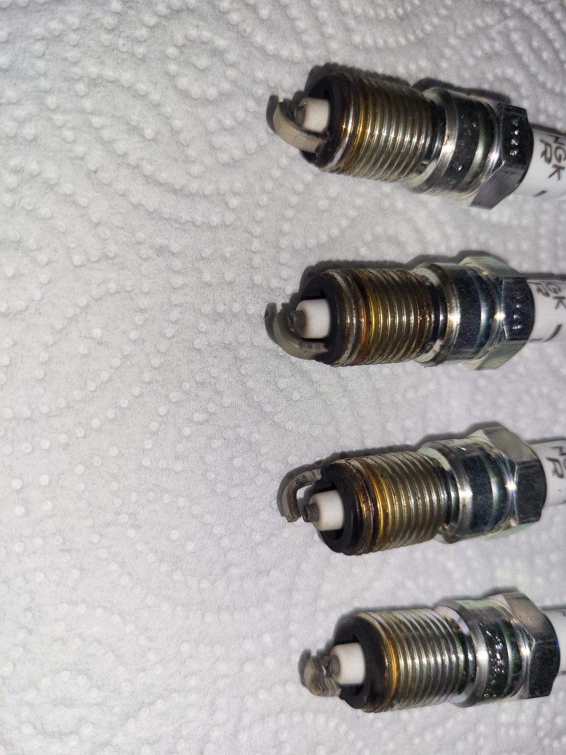

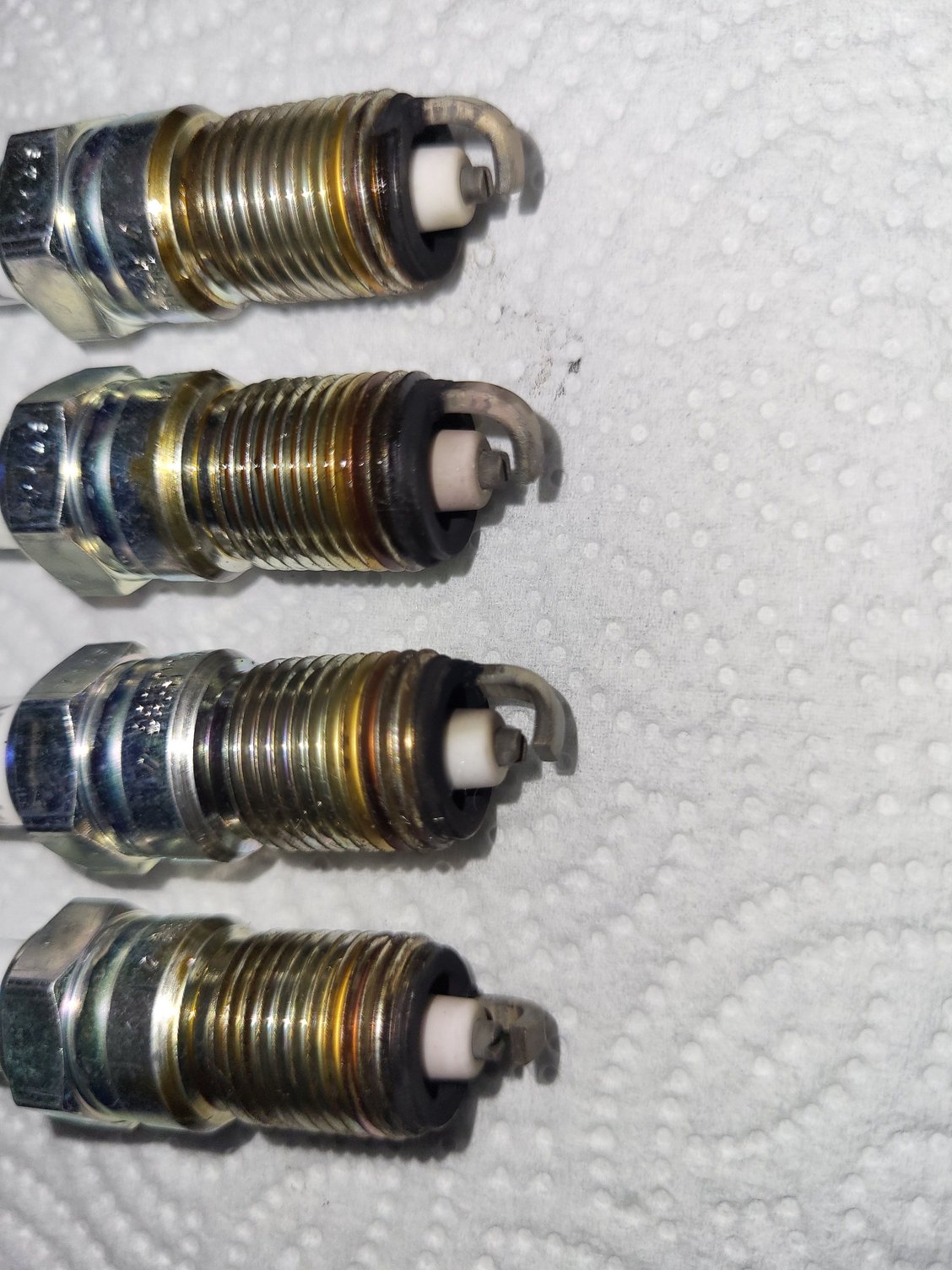

Pretty lost on what else it could be. Spark plugs look perfect after 2k miles

6 speed I'm guessing.
Old heads
Cam for stock sized motor
1 7/8 headers 3" collector I'll assume-down to a 2 1/2" exhaust
HP falling off before 6k
I'm not sure what you were expecting but new cam and exhaust at the very least for improvement.
Nice smooth graph-motor is giving you what it has based on what you put in it and behind it.
You have long tube headers which lets motor make more power at higher rpm and then you choke it down with 2.5" pipe out back.
All imo obviously, I don't think there's anything wrong with the set up as far as looking for something in the ignition or the tune etc. You just have some parts that aren't maximized for the bottom end you now have. You can't compare your 408 to another 408 with better heads, better matched cam and better exhaust.
450 at the wheels is a nice number for what you have in it imo.
How's it feel driving around? Throttle response good? What's the compression ratio now?

Was going to say get a fast102 as the LS2 intakes royally suck but you already have that covered.
With that being said, that cam is too small for a 408.
I would sell heads/intake, swap for ls3 heads/intake and re cam.

I've just re read your thread, I'm confused with your comments stock correction & STD correction. Dyno reports are either corrected or uncorrected, weather & elevation have significant impact on what is displayed regarding power. Repeatable & consistent numbers are difficult on dyno as many factors are involved, corrected numbers removes one variable.
It is difficult to get the same manufacture & model of a dyno to report the same nevermind different shops, when tuning you chase gains & losses more so than peak numbers. Weather, elevation, tires, air pressure, tie down procedure all become factors......they need to be consistent.
You are showing different dyno's in your thread then the stock vs STD correction, smoothing won't have a significant impact. Looking @ your list of mods for the LS2 including gear ratio, on a dyno jet I'm suspicious the accuracy of what is being displayed....as in possibly flattering.
Then I look @ the stroker, different dyno. I think of all the variables I mention. Did you go back to the shop that dyno'd the LS2? If so do you have those results?
Cam timing, I do not see any mention if it was degreed or not? That is a major known or unknown when chasing power. Peaking earlier than the LS2 brings that question to mind.
Chasing a low power issue myself I learned about the cylinder heads air flow. I did make marginally better power with my POS heads same dyno, so there was a small improvement. Just not what I was looking for, when you have a bigger motor it needs more air that's not hard to understand. I believe that choke point becomes even worse from peak torque when you want to carry that number as long as you can for peak HP.
My original stroker was spec'd, built & dyno'd by big names. That shop claimed 535rwhp on a Mustang in ground dyno. Not bad I thought, 550rwhp was my target. So I made arrangement's to visit a Dyno Jet shop on my return trip home after picking up the car. I will never be able to express my disappointment how badly the car ran when I picked it up. Worst running POS I ever owned & it was tuned by the big name pro. Adding to my grief & misery was the Dyno Jet reporting 518rwhp. My BS flaps were already on hi alert & this just pegged the meter. Dyno Jet reporting less than a Mustang dyno, that was confirmation how badly I had been stroked.
Here are my cam spec's for you to compare 231/243 .637/.627 116+3. This is full roller rockers with a good wipe pattern & morel drop in lifters, correct pushrod length after shiming pedestals for wipe pattern.

After reading again, I feel the cam is not terrible, but if the OP is looking for even 600 crank, the cam and heads he has will never get him there. I don't know if that FAST intake would match up with AFR 245s, but if it does, it would save a grand towards another intake. I'm not knocking the ported LS6 heads OR Livernois. But those heads are nearly a 25 year old design, and won't match the 245 AFRs OR the LS3 heads. If it was me, I'd go for the ported LS3 heads, and MSD intake. See how easy we can spend YOUR $$$!! Anyway, if you had the above setup, 11:1 compression, a 240° intake/248° exhaust duration, or maybe a bit less duration, say 236°/244°, with around .630" lift on a 112°-114° LSA, and ported LS3 heads, it may not be a grocery getter, but it sure would be an *** hauler!!! My opinion, YMMV
