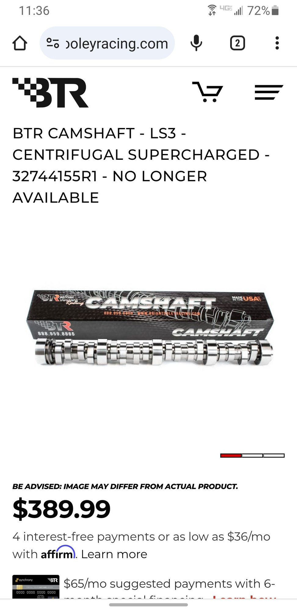

Originally Posted by camaro75racer
I'm running the BTR LS3 centrifugal cam and it runs and drives GREAT. Car is still setup and tuned very conservatively but is a beast. Highly recommend it.
227/244 .618"/.604" 115+5
https://briantooleyracing.com/btr-ca...-32744156.html
I just went to the website to check out that cam since I have an ECS kit and it said it's no longer available!
I think the BTR Redhot cam replaced this one and I believe they have comparisons and it made more power everywhere.
