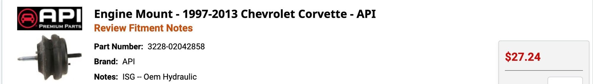

Can someone confirm that this is the motor mount for our cars? Only $27 each !!!!
Yeah, they'll work but I prefer OEM.

Avoid Chinese quality when it comes to motor mounts. You can get the OEM mounts for not much more than those on Rockauto.com
