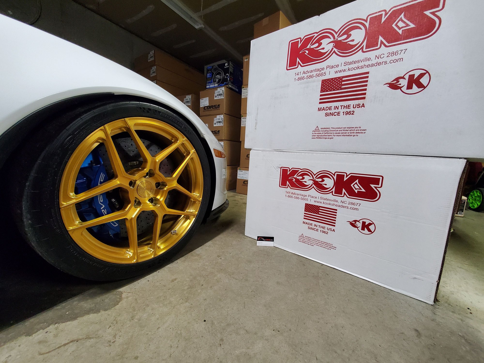

I have a kooks 1-7/8" header + off road xpipe ready to go for your C6 let me know if you'd like to make a move on them. You can call or text me direct I can send you video. Will ship your way tomorrow. 201-575-0861

If you have to cut a kooks or arh header system for fitment purposes, something is very wrong. These kits are not designed for that. They are designed to work with their own midpipes. I believe the super cheap (low quality steel) headers from Dynatech and/or Flowtech can be used with the oem x-pipe if you cut that x pipe somewhere in the middle where the header assembly would meet up to that piece.

Are you a vendor? What's the price?

$1699.99!
