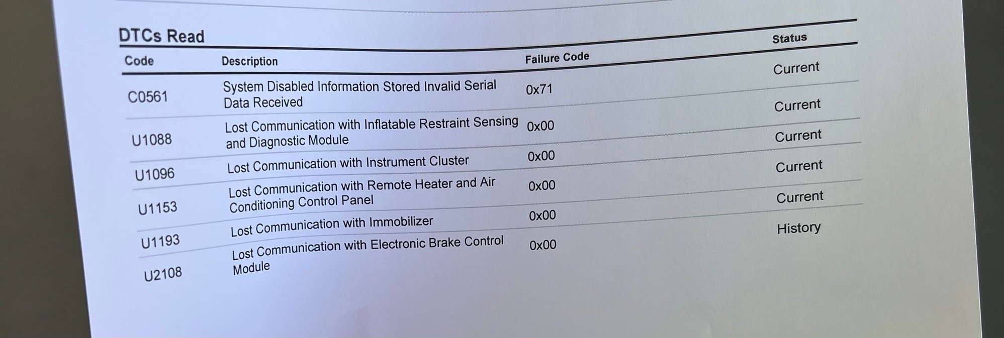

Codes are as follows:
  • C0561
  • U1088
  • U1096
  • U1153
  • U1193
  • U2108

If the dealership will be diagnosing this don’t hold your breath !!…all the “U” codes are communication codes…hope the dealership uses a CAN “break out box” and a labscope because it not they will only be guessing and that will be expensive for you !!..find yourself an auto-electric or a “diagnostic” shop in your area...what city is the car at now ??…won't be able to diagnose this for you over the Internet unfortunately…video below so you can see what’s involved..BTW dealers don’t use scopes !!...BTW do you have ANYTHING plugged into the OBD2 port ???

The U2108 is loss of comm to the EBCM and since you had the dragging brakes I’d maybe focus my attention on that module if you do try to diagnose it yourself…you can try removing the EBCM connector and then jumping across the CAN wires to basically take the EBCM out of the circuit (jump B9 to B10 and B11 to B12) and see if all your issues resolve themselves..the CAN lines are easy to identify because they are “twisted pairs”…pic below…checking the resistance of the CAN bus wiring with a DVOM is the normal SOP if you get that far…saw Spitfire Auto Electric in San Antonio may be a good choice.

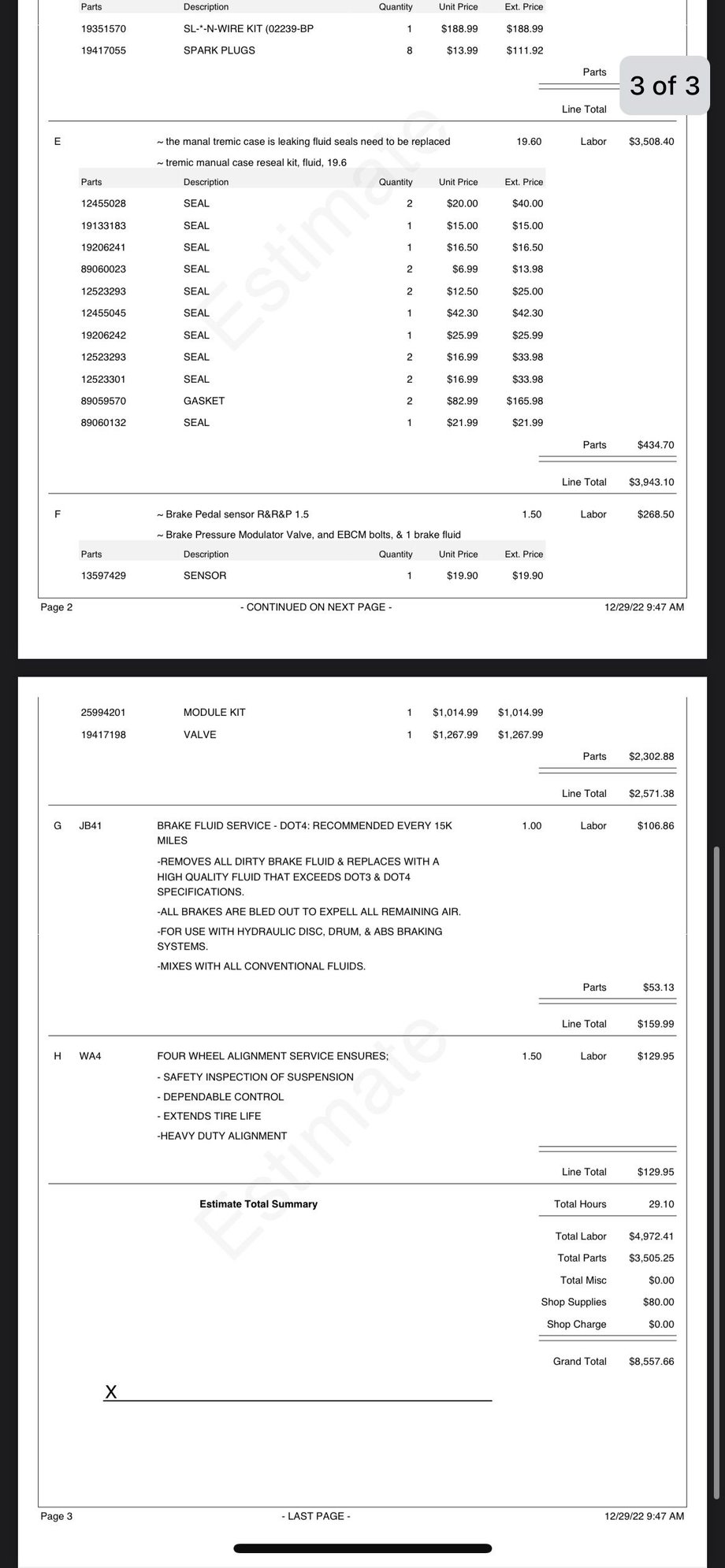

Update: Leaky transmission and a brake sensor/ modulator valve issue per the Dealer…
Huh ???..is it fixed yet or are they still guessing ??
Old Dec 29, 2022 | 01:59 PM
Agwilson96's Avatar
Agwilson96
Joined: May 2019
Posts: 28
From: Boerne, TX
I just had them diagnose it. Probably guessing. They haven’t done any work.

Just stopped by the dealer on the way home. (work in south Texas, live north of SA)
Tech stated car was completely dead when he looked at it. Had to charge battery.
Said it starts and shuts off as it should, gauges work, or all works, just got the brake codes…
Mentioned something about the car being in a “logic lock”

Never heard of “logic lock ??..if you do change the brake pedal position sensor it will need a calibration.
