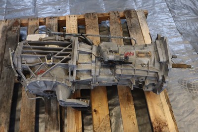

Also for reference heres a picture of a 6l80e connected to a c6 diff... again note the axle placement
And again for reference, the relatively compact tr6060
