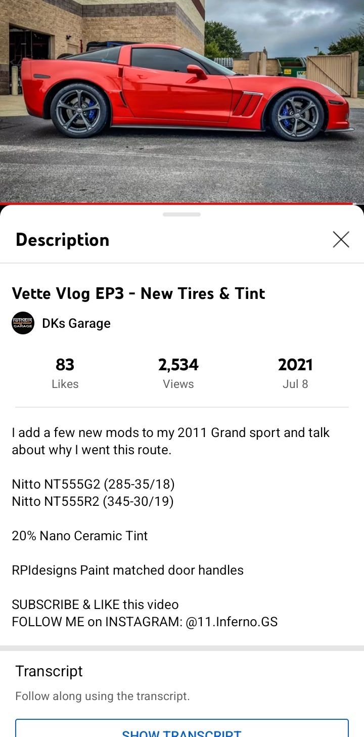

So these are the sizes I was thinking of. If I accidentally typed it differently on my previous posts, I will go back and edit to correct them.
No worries, looks like the sizes I was thinking.
