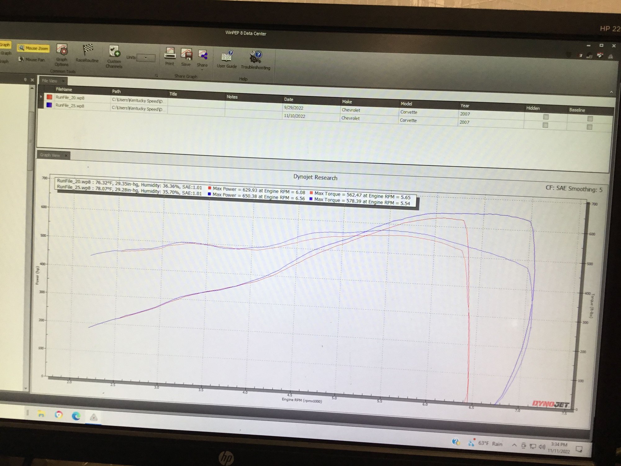

here the difference between 1 7/8 headers and a stock msd 7 intake
and 2” headers and the same intake ported by Greg Good,i didn’t have torque loss

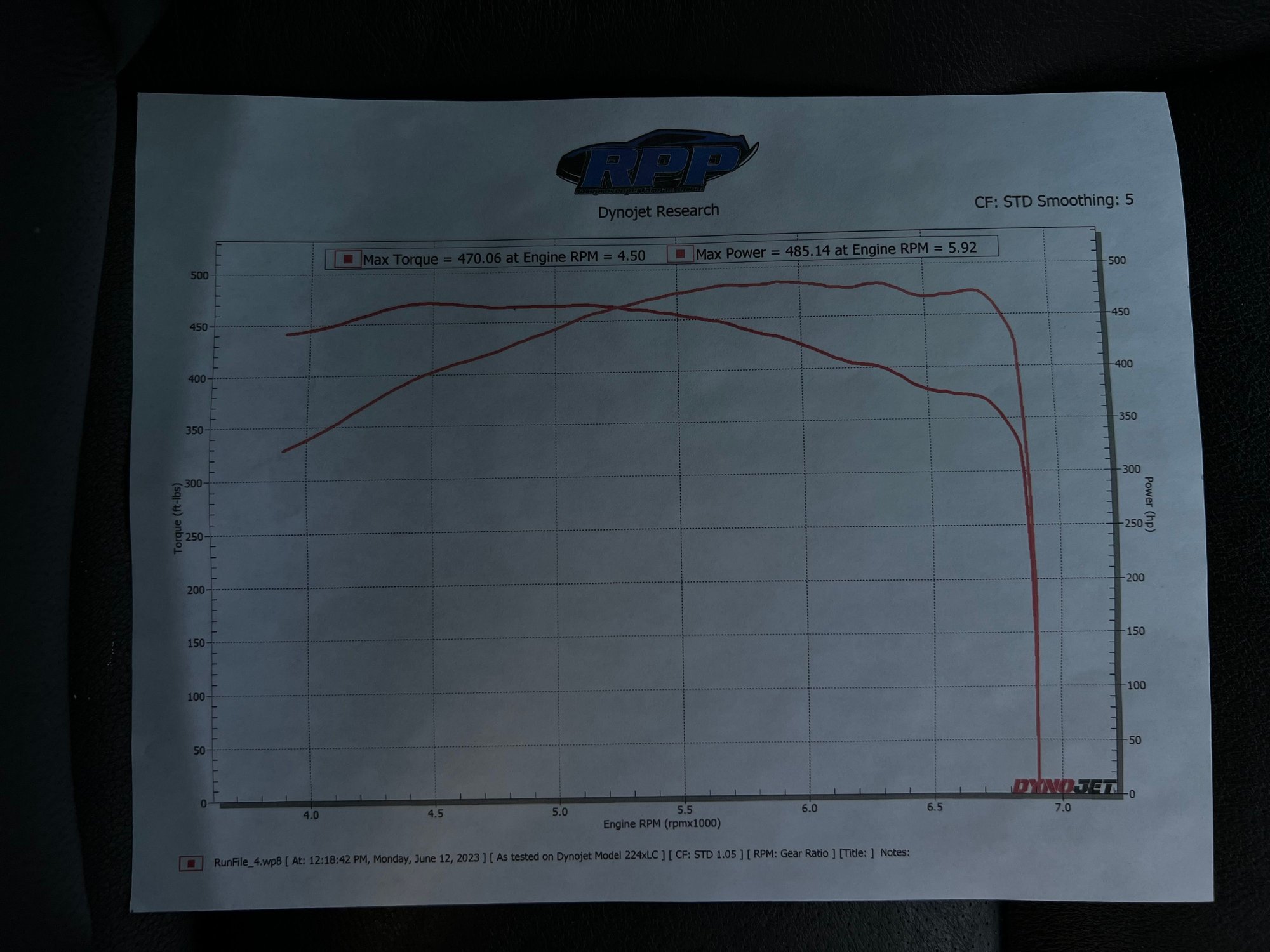

Got it tuned yesterday at race proven performance in Harrodsburg, ky and couldn’t be any more happier, said I could get higher numbers if we let it cool off some but I’m not chasing numbers

Originally Posted by Last 1
Don’t have buyer remorse( IF) your a first time buyer buy 2” headers
so if you ever decide to move up to power adders ,you will have it covered
Wow, you didn't lose anything at all.
I think the difference between 1 3/4 to 1 7/8 would be more pronounced that 1 7/8 to 2" but still, you're right-plus you picked up a good amount up high.
