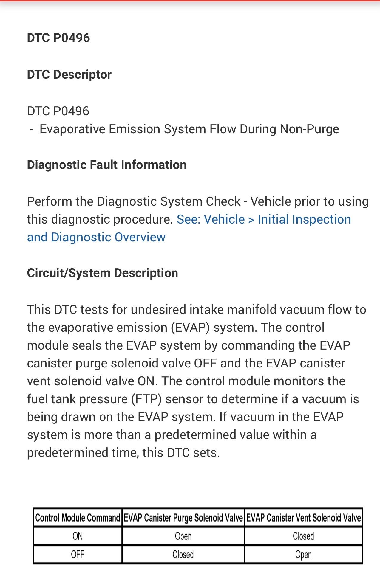

I saw you had another issue a few weeks ago with a P0496 (EVAP flow during non purge condition) which tells me your purge valve may have been stuck open drawing those EVAP canister fuel vapors into the engine resulting in a rich condition which will damage your cats…if you have a scan tool and can graph your 4 O2 sensors if the downstream sensors look like the upstreams your cat is shot !!…the other cat is probably not to far behind.

I’m still getting the P0496 after replacing the purge valve. Code reader is giving me (6) different things to look at.
(1) Faulty evap canister vent valve
(2) purge valve. (Changed)
(3) Plugged evap canister condition
(4) Faulty evap pressure sensor
(5) Evap canister vent valve harness is opened
(6) Evap canister vent valve circuit poor electrical connection

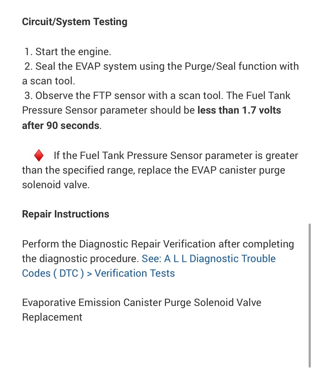

With your code reader see if you can look at the “Fuel Tank Pressure Sensor” data PID voltage and also if you have the same PID but is for “inches H20”…these code readers are sometimes useless when trying to diagnose these cars…with the engine NOT running you should see 1.5 volts..this is the voltage for atmospheric pressure in the tank and is applicable to mostly all GM cars…now start the car…if there is vacuum being applied to the fuel tank the inches of H2O value will be a minus value and the voltage will increase from 1.5 up to however much vacuum is in the tank…what sets the code is the ECM see “more than 10 inches of H2O vacuum for 5 seconds during non purge”…if everything looks good leave the scan tool plugged in and clear the code and go for a drive and see if the tank goes into a vacuum..the EVAP test may not run…you can try unplugging the purge valve taking the electrical circuit out of the picture and watch for any tank vacuum…”maybe” the ground wire is shorting out which will open the purge valve…the ECM controls that ground but I’m thinking you would see a P0443 if the wire is shorted…0443 is a “circuit” or wiring code.

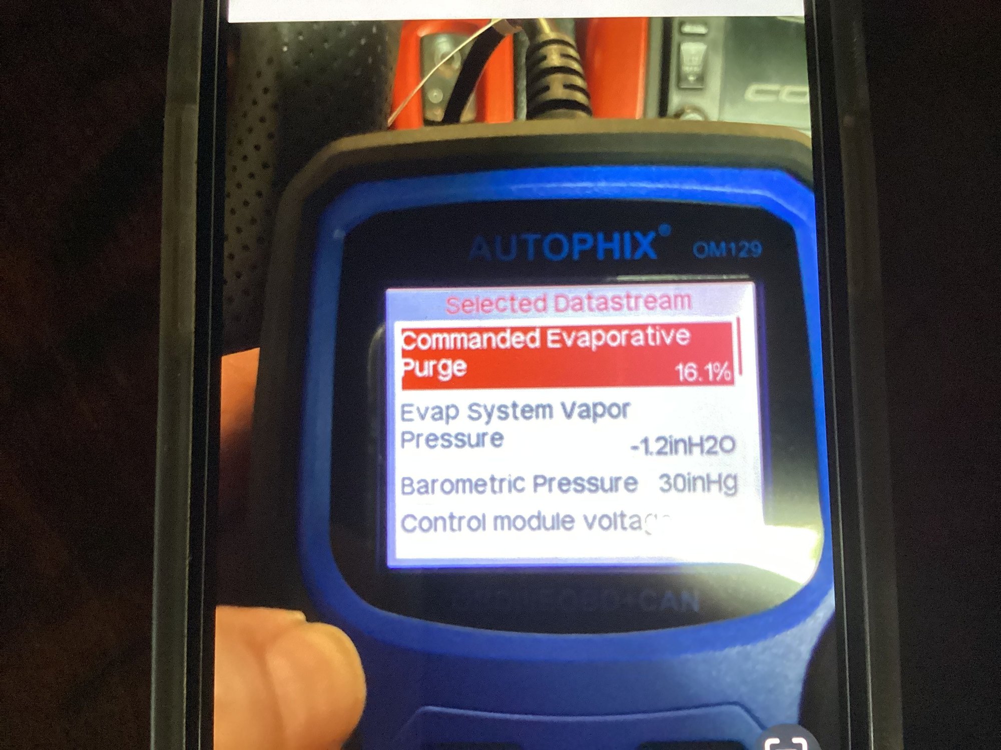

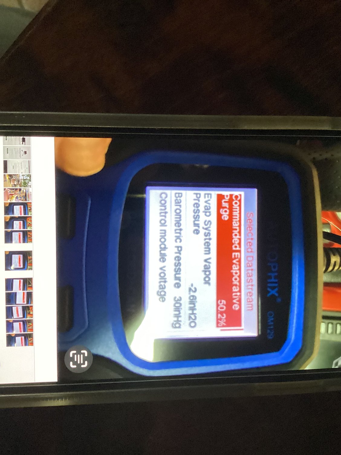

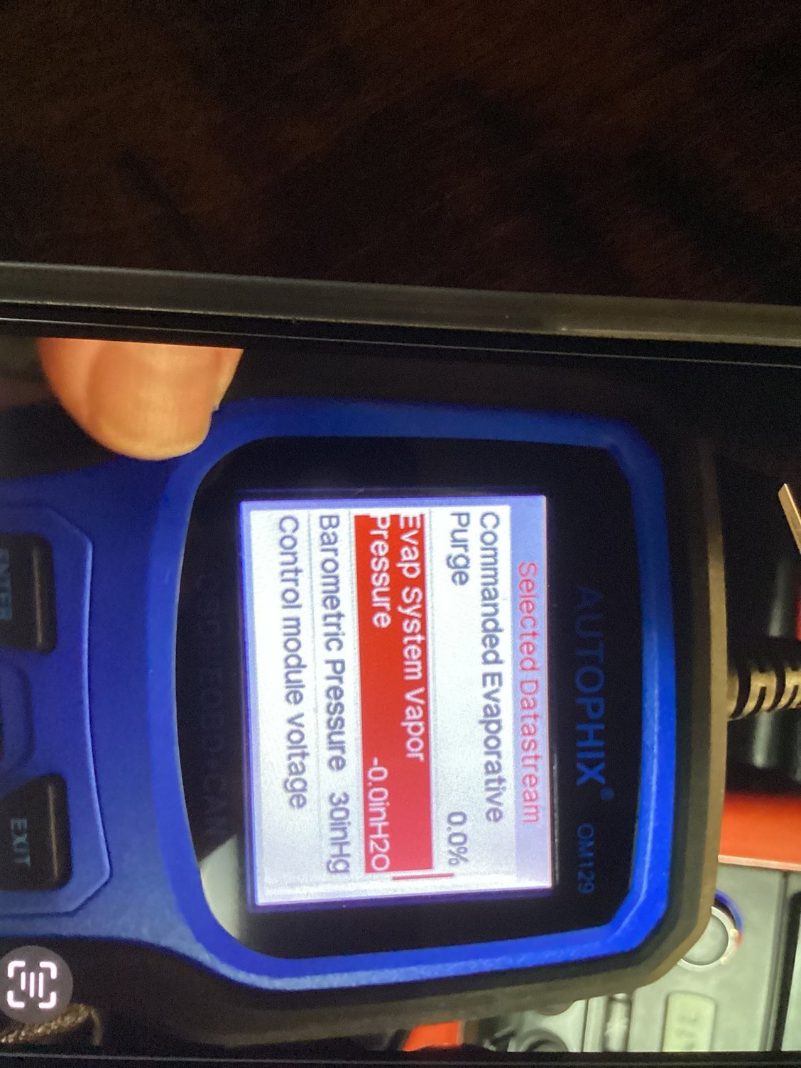

Okay, I think the code reader that I have isn’t going to have everything I need. I did get a little information from the Data Stream that it has is limited. Going to see if I can find someone who can check with a better reader.
Engine at idle
Engine at 3000 rpm
Engine not running , powered up

Looks like your tank is in a vacuum at idle…don’t know why your commanded purge is at 16% at idle ??…should be 0% !!…maybe it’s testing your EVAP system.
