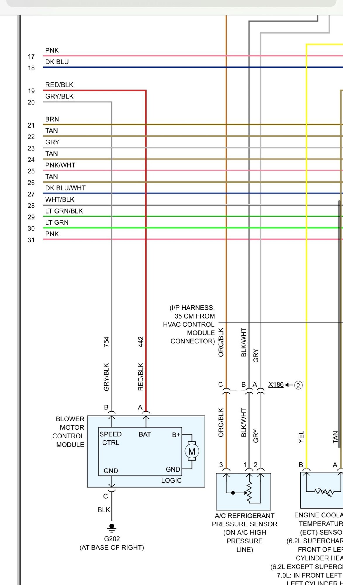

blower motor for AC not working anymore. fuse seems ok. anything else i should check before i buy a new one? 2012 GS coupe. TIA
Old Jul 5, 2023 | 05:41 PM
C5 Diag's Avatar
C5 Diag
Moderator, Tech Contributor
Posts: 15,600
Likes: 4,059
From: Cape Coral, Florida
Why are you going to buy a new one before testing the old one ???…could be the module, a bad connection or the wiring…could also be the HVAC module itself…wiring below is for a 13 but should be the same as yours.

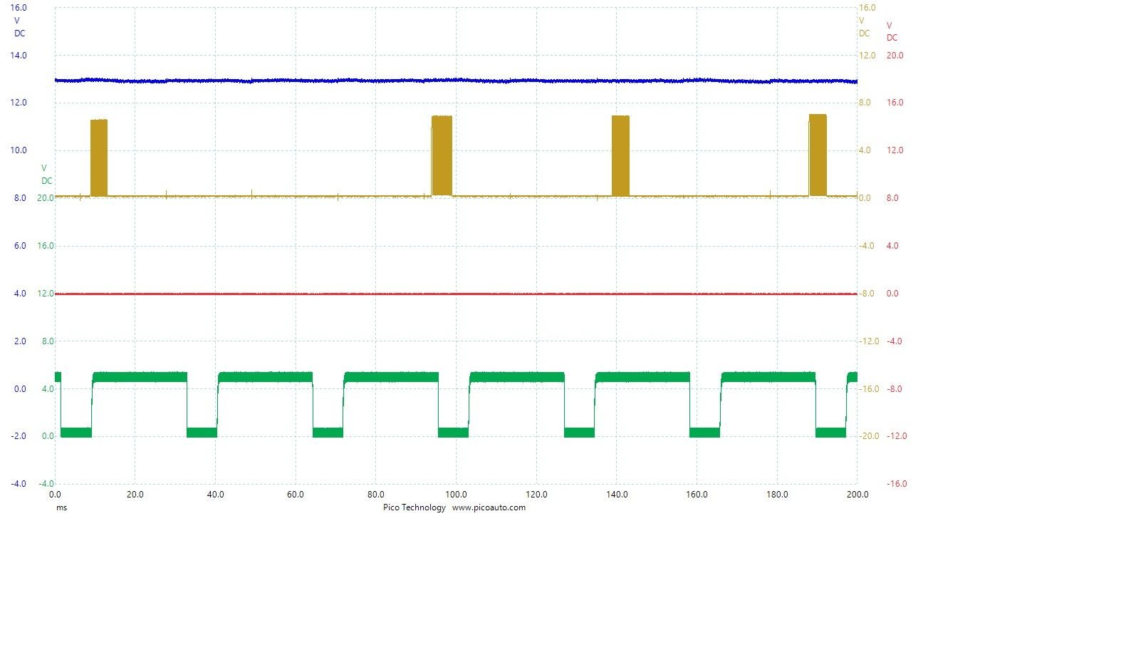

I assume to do a proper bench test you would need a PWM signal generator for the speed control?
Old Jul 6, 2023 | 10:42 AM
C5 Diag's Avatar
C5 Diag
Posts: 15,600
Likes: 4,059
As long as you have either an advanced DVOM that can read PWM in milliseconds or a scope it can be done without removing the motor...below pic is scope capture of a C5 I did a while back also with a PWM signal...power (blue), ground (red) and the PWM signal (green) were all checked.

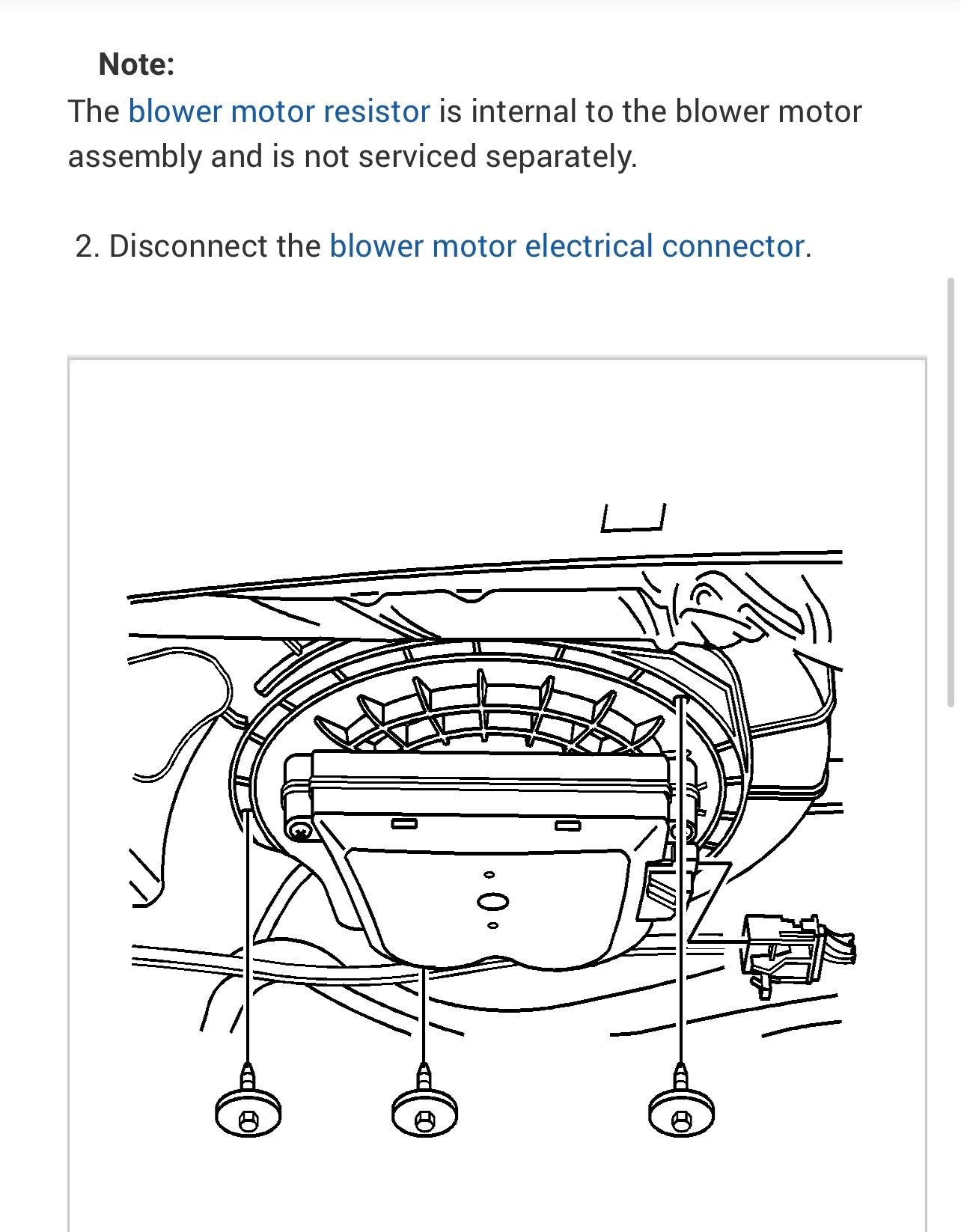

Originally Posted by C5 Diag
If you applied 12 volts and a ground and the motor doesn’t work you’ll need a new one.
ok, thanks. is the resistor built into these newer model motors? i could not find a replacement one
Old Jul 12, 2023 | 04:30 PM
C5 Diag's Avatar
C5 Diag
Posts: 15,600
Likes: 4,059
I looked at a 2013 and the blower “module” or resistor is part of the blower motor assembly…yours should be the same.
