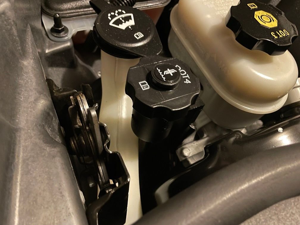

Sounds like air in the system possibly? Are you sure it had the updated master cylinder with the black reservoir and Dot 4 on the cap?
Yupp previous owner had already taken it to the dealership for the recall
