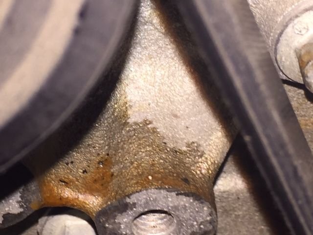

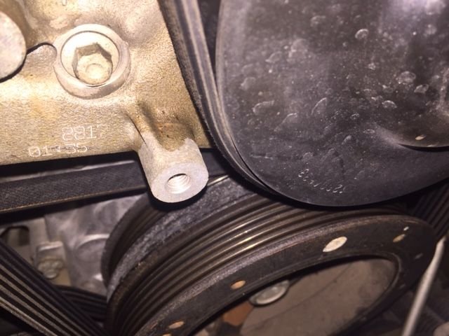

C6 Base ~45K miles. Saw a bit of coolant (teaspoon) on the floor. I just came in from out underneath it. This is my first stop. I did remove all the air cleaner plastics and have it up on the Quick Jack and have gotten a decent look around. I do see coolant sticky and liquid in a few place but not exactly where it's leaking from...I'm headed into the water pump, seems the most obvious....So I guess what I'm getting at here, Anybody know a Good YouTube or step by step here on CF to get into the Water Pump or something else like a hose or gasket I should be checking?

That all looked ok. Most of the leaked coolant is on the pump housing and pullies. Thanks!

Yep, I will check into that, I think loan a tool at O'Reillys. It's lookin like the water pump tough.
Time to look for torq specs, belt routing...RockAuto looks to be the least expensive or O'Reilly's because they're nice people, 50 bux more(?) though...

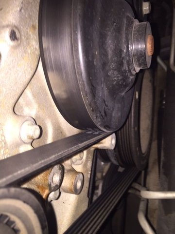

All of the leakage seems to be on the righthand side:

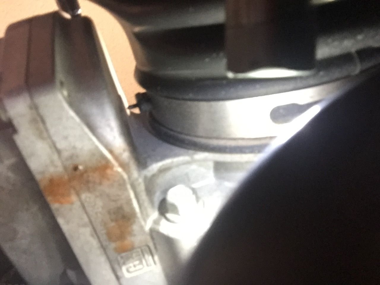

This ones kind of confusing because it's up high by the throttle...

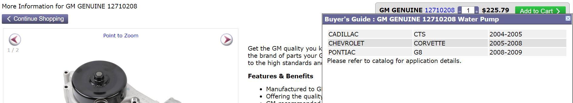

Here is the part # for the pump 12710208

Ken, Thanks for your input. Threw me for a loop for sure...Spent about an hour/hour n half researching part numbers. My part ordered a few days ago, eta this Monday or Tuesday.
2009 Part Number off my leaky Water Pump (Just the Pump less Thermostat and Housing ): 12604630 (GM, ACDelco no longer use this number).
2005-2008 Water Pump w/thermostat and housing, your Part Number: 12710208.
2009-2013
Water Pump w/thermostat and housing: 19180610. The one I ordered.
Naw, but really this is Good in case somebody else with a leak stumbles a cross this...and I came across on Corvette Forum where some guys might have talk about the slight differences already, inlet/outlet diameter or pipe connection bends, not exactly sure... I'm hungry. I'll post back latter...
2009-2013
Sorry I gave you the wrong part #..My 2008 has a LS2 pump it changed in 2009...Same bolt pattern but the rad hoses would have to be changed.

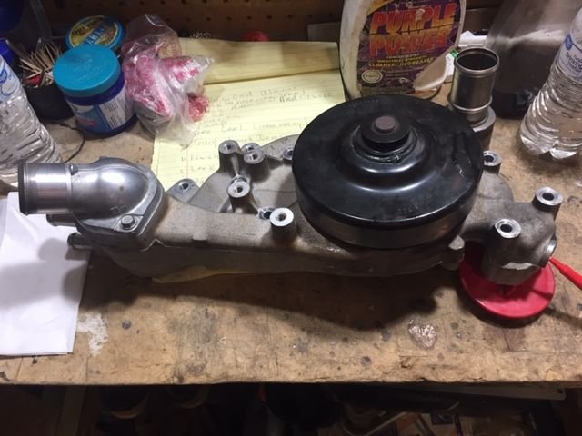

Damn! I dropped a piece of pot pie and the dog got it.......The Pumps here...

It is most likely a water pump seal leaking. It happened to mine at 30K miles. I used a coolant pressure tester to find the leak. Finally got to see coolant dripping from the pump seal area.
replaced, and now 125K miles and no issues since.

Epilogue: Radiator Pressure Tester is a Real Good Idea, "Rent-a-Tool" O'Reilly's . Pump to pressure written on reservoir cap (mine is 18psi). If it's a slow leak it might take ~ an hour to make itself somewhat obvious. Seeing exactly where a leak is behind the pully is impossible but you'll get a good idea when you see fluid wetness/drips below Water Pump pully. All tracer dyes I saw said Not for GM btw, but you do have a Very Good shot by chasing the coolant wetness. Oh, and yes, check all hoses and clamps, but if the pumps wet it's a pretty good chance it's the pump. ACDelco pump for a 2009-2013 Base Corvette with thermostat, thermostat housing and gaskets cost me just under $200 total (Amazon). That's the least expensive I could find.

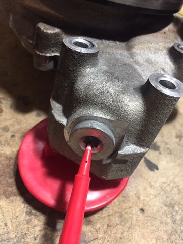

Aaaand I do have on last question about these C6 Water Pumps...
What's this Hex Plug for?
