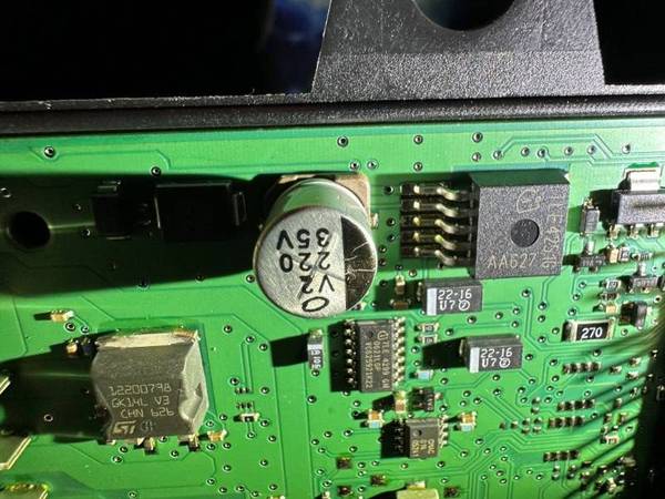

I'm dealing with BCM issues on my 2007. I replaced a suspect electrolytic capacitor on the board. So far so good but it's too early to tell. The issue was random.

Posts: 7
What lead you to focus on the capacitor? Did you have any codes that would help? Thanks for your info!
Experience with computer motherboards. Also the Capacitor plague.
18 years is pretty old for an electrolytic capacitor.
