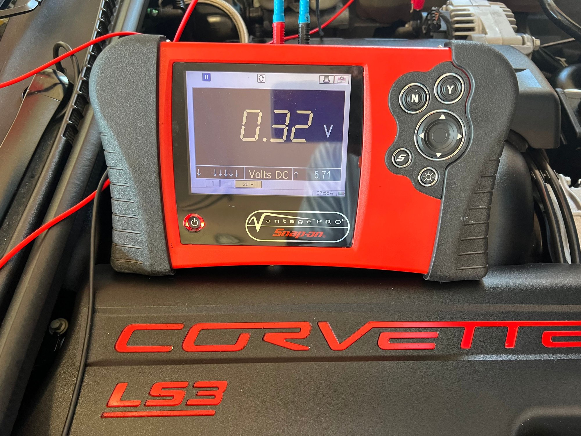

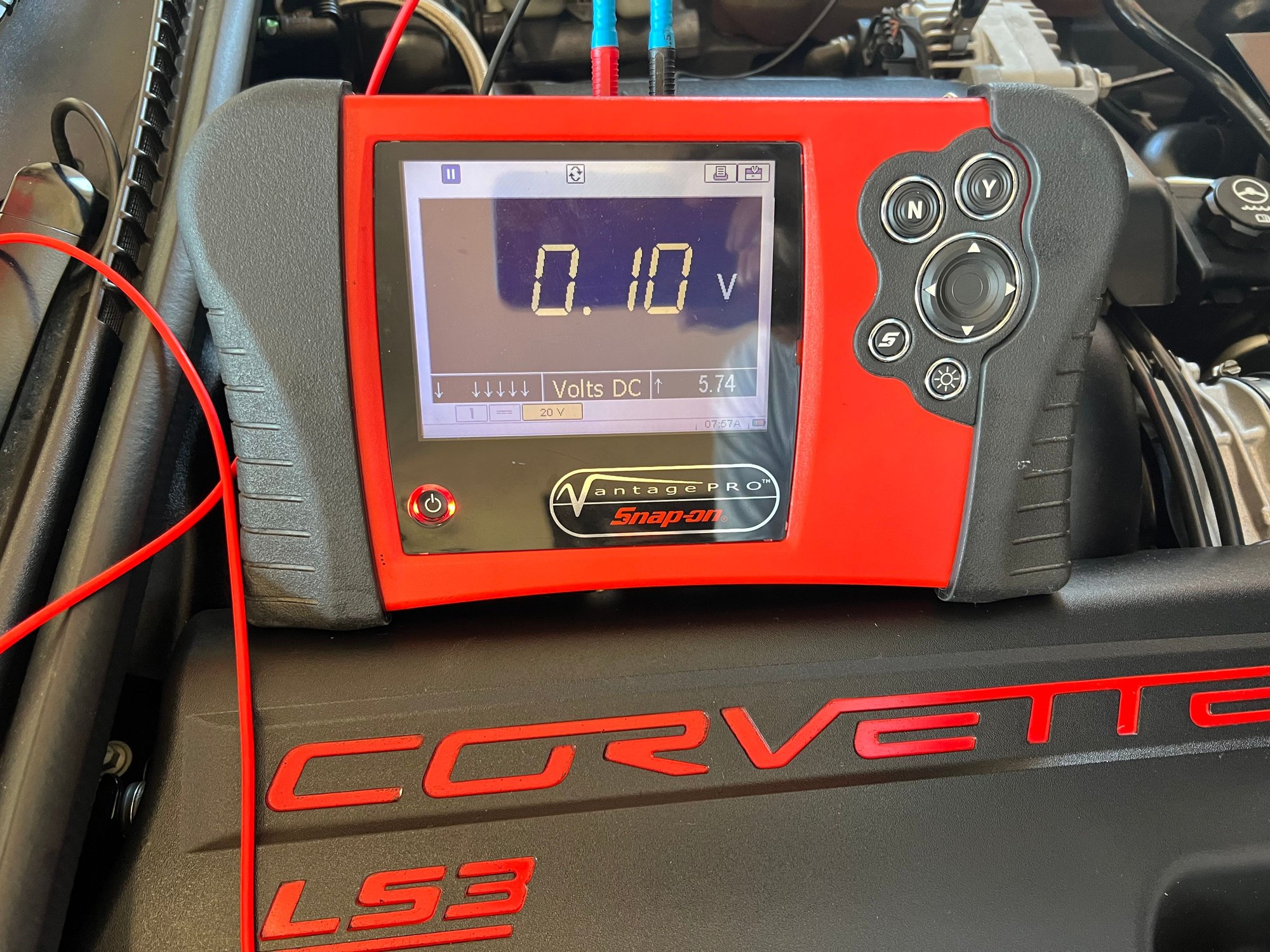

To do a voltage drop check put an electrical load on the alternator and run the engine at 2500 RPM…put one lead of voltmeter on alternator B+ and other lead on battery positive terminal…shouldn’t see more than 0.5 volts…to check negative side of charging system one lead on alternator case and other lead on battery negative terminal…shouldn’t see more than 0.5 volts…this is what I see on my car 0.32 on positive side and 0.10 on negative side.
