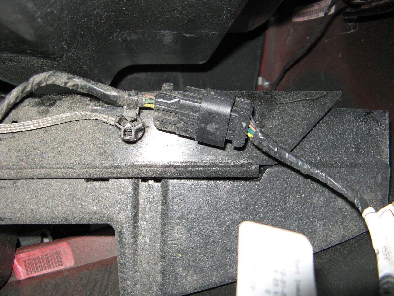

As for problem one, remove rear inner passenger tail light, and inside the void and slightly down, check the connector for corrosion.

Look at this. This connector is a common place for corrosion and does funny things with tail lights...
https://www.corvetteforum.com/forums...-stays-on.html
