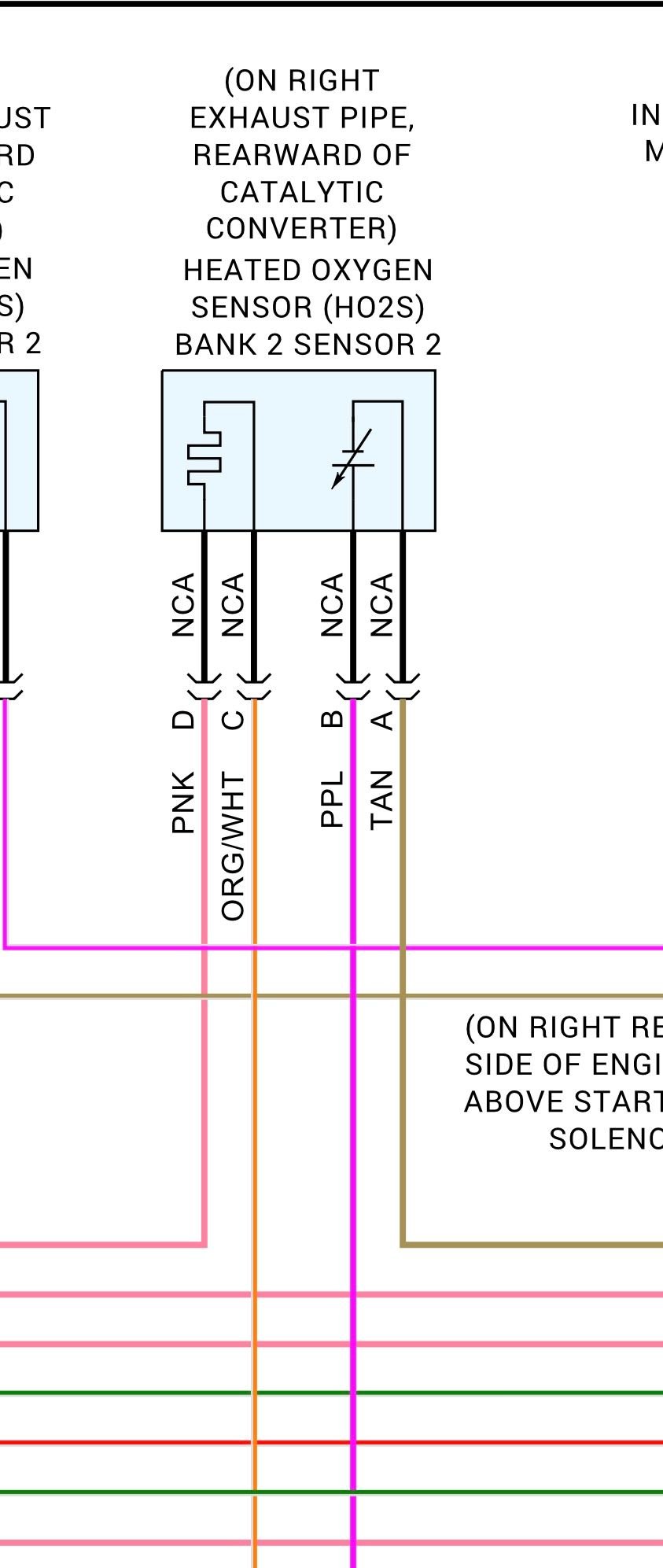

The pinout for Bank 2 Sensor 2 below…usually the heater circuit on the sensor side of wiring are the same color wires…on the harness side the pink wire is power and the Orange/White is the PWM ground from the ECM…I’d rather use a 1 amp bulb to check for proper current instead of just checking for 12 volts at the pink wire…to check the control you might have to clear the O2 sensor codes for the heater circuit to be able to function again…hook up a test light to B+ and touch the tip to the orange/white control wire and make sure the test light flashes to signify good ECM control…if no good you should check AT the ECM to make sure you don’t have an open in the wire…could you fill out your profile so we know what model year, manual or auto trans, mods, tune etc…I’m using wiring for my 08 in this post…I had to search your posts to see you own a 2010 GS.

Yes, 2010 GS.
Thank you. I will check this out. My logic is either a wire at the sensor got damaged when pulling the stick cats down, or the extension harness was not good from the get go.
Everything Worked fine before the longtube install, but I let a little bit of the weight hang on the sensor while trying to hold the cat up and unscrewing the sensor.
