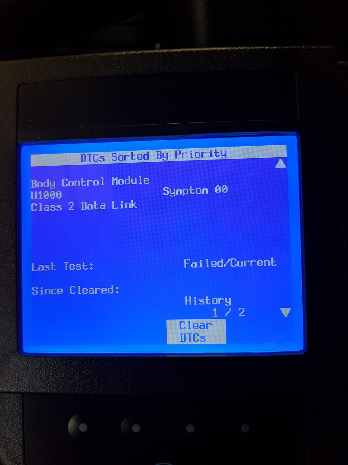

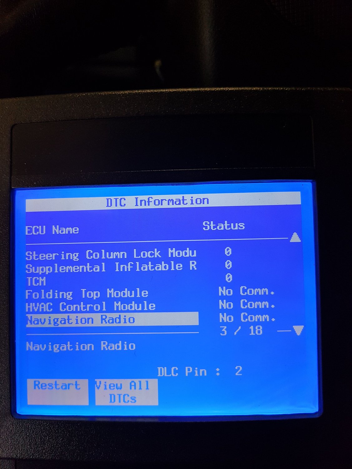

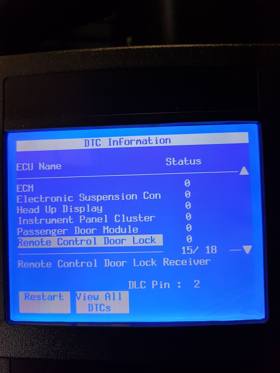

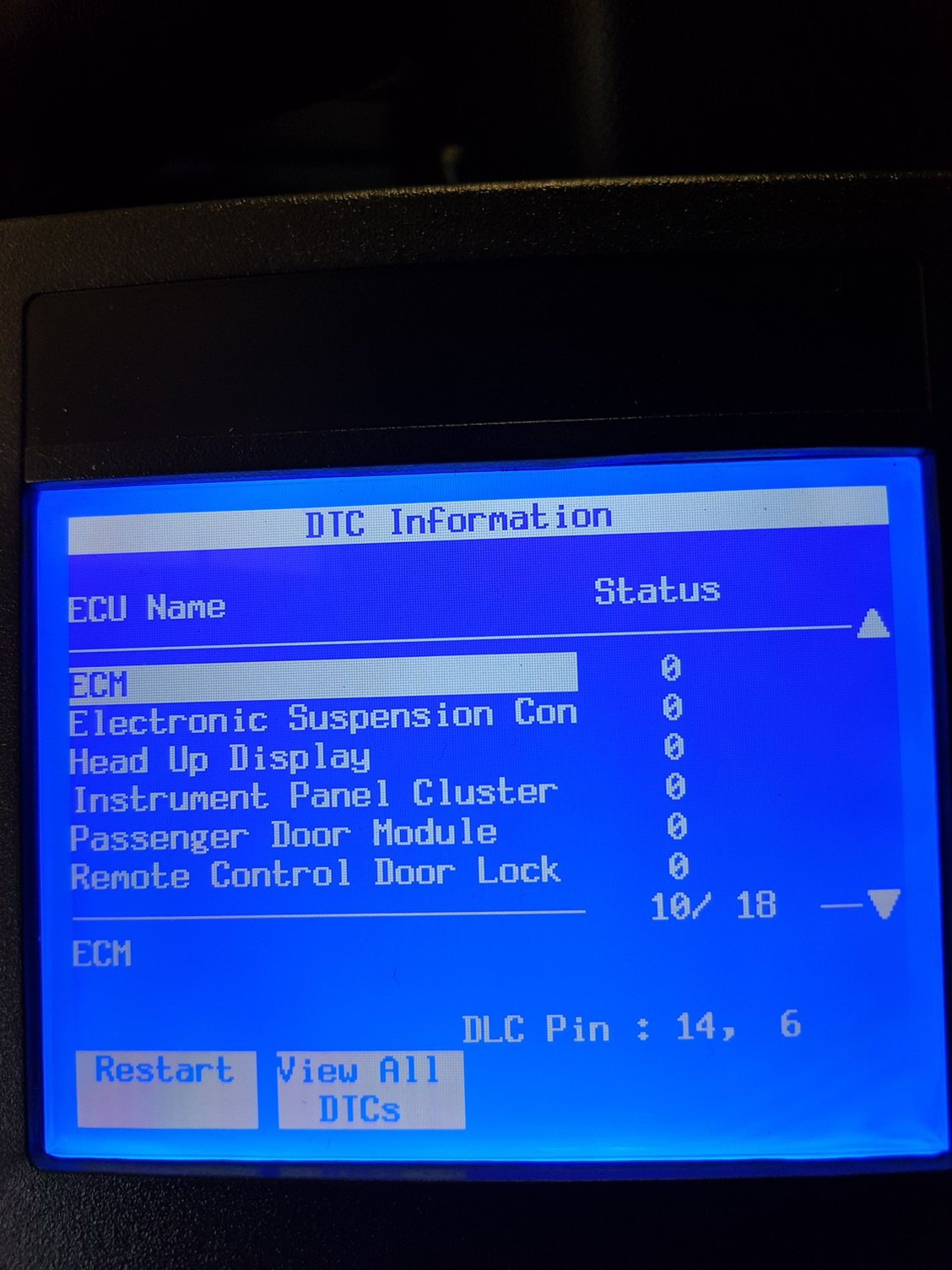

Hi everyone, I´m from Sweden and need HELP!!
, I don´t know what to do? I have asked before and got a lot of information and nothing works....What are my problems. I get "Engine reduce power" rather often and engine just stops. I have buyed to New Battery, New Alternator, New sparkplugs, New Ignition Coils, Check all Electrical conections. New Throttle pedal. Buyed an TECH II. Today My Vette, got"Engine reduce power" again, I Enclose some pic from
TECH II. Give me some advice how I shall go further!

ECBM, and BCM.
Disconnect the battery,
Pull the connectors on the two, including the red center connector with 8mm bolt on the BCM, and use spray electrical contact cleaner on the both the connect and socket pins.
With lost communication between the two, most likely corrosion problems at the connectors causing the problems.

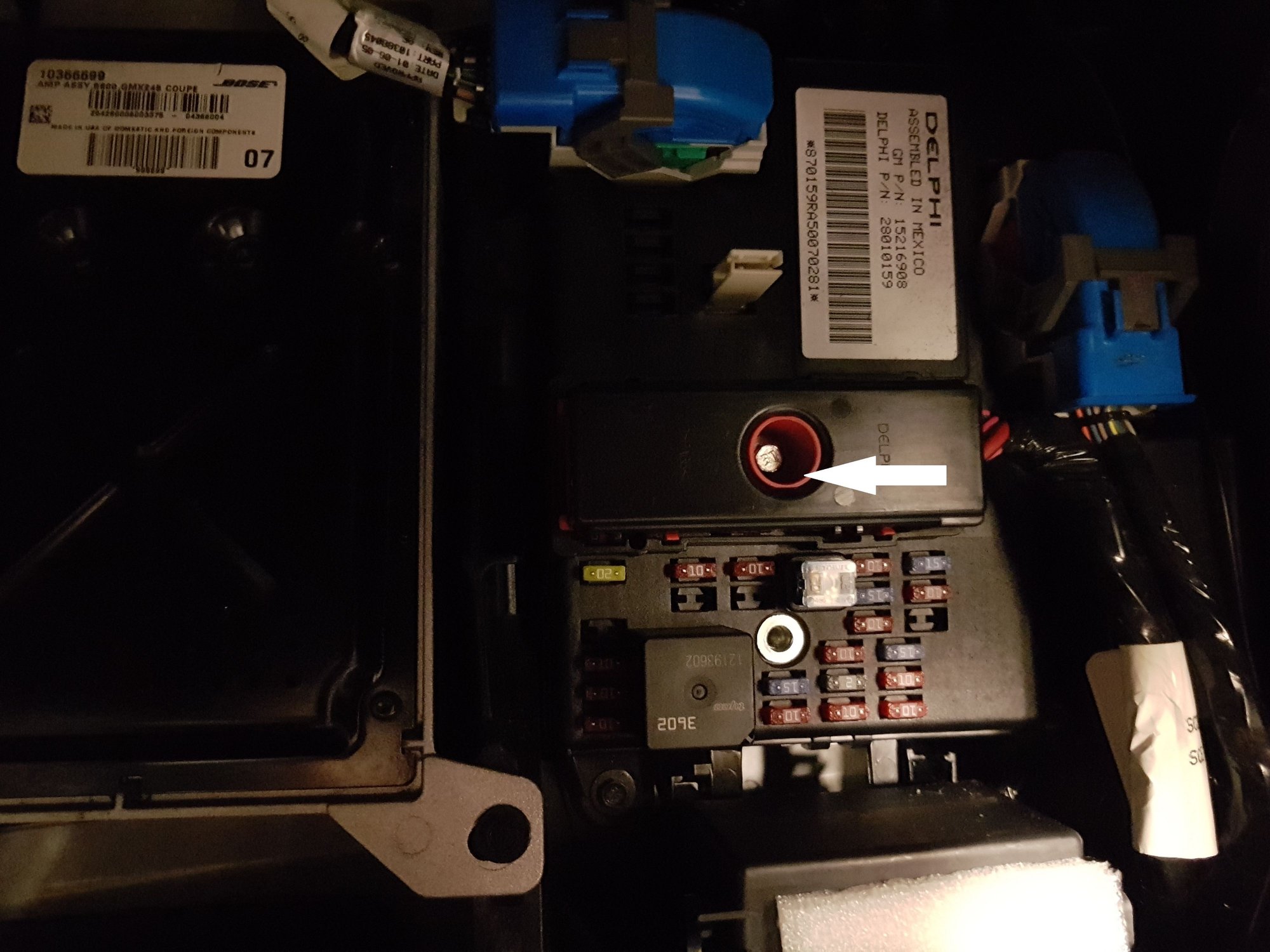

Dear Sir!
I went out to my car and take an Pic. Am I right. I put in an white arrow in the pic. Is that I take away the screw and lift the contack up and Spray Electrical cleaner om both side.

Yes on the red connector, but make sure batttery is disconnect before you remove it to clean, and do the blue connectors as well.
and his is the ebcm, to location in the engine bay, and just need to pull it connector to clean it as well.
https://www.motortrend.com/how-to/18...vettes/photos/
After that, would pull the accelerator pedal and throttle body connectors, to given then a good contract spray cleaning as well for good measure.
